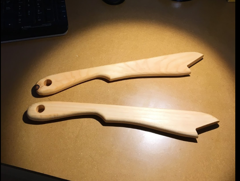

    Hi Moniker, Sorry for the delay getting back to you. We've recently moved and life has been busy! I don't recall the exact dimensions of the aluminum plate but I tried to keep it as large as possible for mounting clamps and things. Now that my new wood-shop is finally getting setup, I will be getting back at this machine and posts! I made a couple of push stick with it over the weekend.
    Check it out:
    -Jamie

    btw those push sticks make a great project as well!
