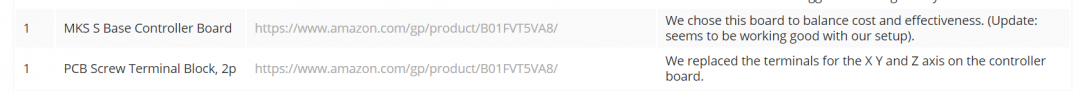

  4. khalid tubail
    May 13, 2014
    dear friend
    i like your project and i am exciting to do like.
    i checked all parts you added, why you added two same items with different description.
  5. SBLabs
    SBLabs Well-Known
    Aug 16, 2016
    33
    49
    Copy and paste error. Thanks for catching this. Updated.
