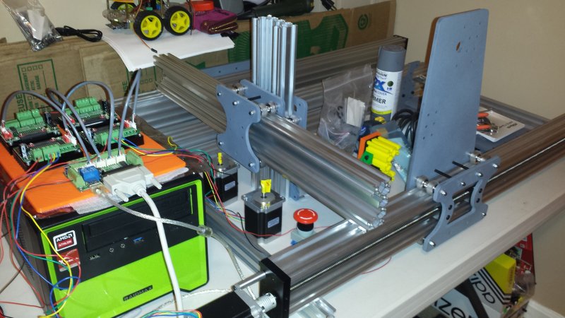

    MTO published a new build:
    Read more about this build...

    I wonder how well fan folded duct tape would hold up.

    How funny! I was just looking into making bellows for my OX last week. There are some videos about it on Youtube if you want to know more. I think it is most likely the best option to keep dust and debris out of the rails and wheels. It's used by lots of CNC machines.
    The paper solution didn't appear the best option to me, that's why I placed it on the shelf for now until I dream up a better material to use. But it is the way to go, I guess.

    Well, there's 3 issues. First, I think it would take the folds OK and resist mechanical failure from being stretched and compressed repeatedly, but second, I don't think it will be very thin. Where paper is something in the range of 0.1mm thick, duct tape is about 0.25mm thick. That's a big difference, but its also something you can account for and design against. Third, I'm not sure about how duct tape will handle hot chips when you mill metals. Its OK for warm to the touch (ie: less than about 40C/104F), but swarf can be much hotter than that. I hope this weekend to do an experiment with duct tape and a shower of sparks from an angle grinder to see what happens.
  6. MTO
    MTO Well-Known
    Dec 5, 2013
    35
    35
    Paper is cheap and easily obtained. I figure its awesome for a prototype. I don't think I'll trust it in the long run though, because I worry about it catching fire when milling metals. Also, it will eventually tear along the folds. I've had paper tear just as I was doing the folding.
    As I said, I'm going to try treating the paper to be flame retardant, and that will be one issue down. The other thing I want to try is getting some thin cloth (I was thinking ripstop nylon, aka sail cloth) and then treating that iwth flame retardant and then HEAVILY starch it. It might be possible to make it work by sewing along the seams. Setup would be a little tedious, but its all straight lines, so it shouldn't be too bad.
    I didn't find any CNC videos on the subject, but I did find a few on paper-folding. I haven't found any tricks to make it easy though.

    How about just facing the C-Beams to the outside. This way you wont get any chips in them.

    This is more aesthetics than for protection, but if you wanna try you only need these requirements: a soft material that can be easily cut with exacto knife, a 3 mm or 1/8" thick material.
    Then mark and cut 8mm or 9mm of width and the long of the stripe it will depend of your v-slot size, this works for any V-slot and their variants, the C-Beam work too, and don't worry this will not interfere with any type of the V-Wheels including the V-mini.
    You can use soft and slim wood, plastic, cardboard, any material that would be softer enough to be easy to cut, why not plexiglass, because a harder material will do have some troubles when a chip come across the v-wheel and the v-slot cover.
    Color can be spary paint or vinyl (vinyl for cutter plotters like roland or cameo)
