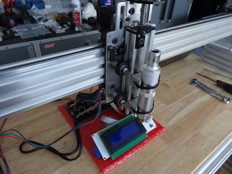

    On the work bench is a new very minimal V-Slot Phlatprinter I have been working up and it uses a new low profile gantry system that can be adapted to lots of different machine types including a table based foam cutter. In fat that was the first build of the VSlot Phlatprinter and I still may go back to it since the rollers are proving to be difficult to make. The new Phlatprinter as it stands will also use some 3D printed parts to get the job done (if we go with the roller design).
    The bottom line is I want a great easy to use foam cutter and for me the Phlatprinter was that machine. It had its issues with tolerances and it could be a paint to cut lite ply/balsa pieces like you say so switching to a table may be the way to go after all.
    I think I will start a vote on the idea of rollers vs. table and build from there. I already have a couple prototypes for testing ;)
    p.s. the table version uses a foam 1/2" spoiler
    Here's a sneak peak of the low profile gantry that can be use on lots of machines. Simple and compact is what we were after with this design. More to come as we get closer to completing the build...
