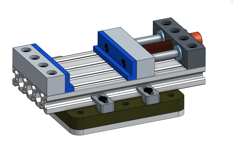

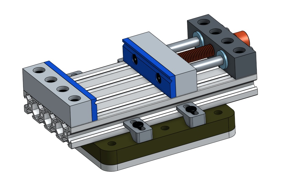

    Hey guys,
    Chris over on Google Plus asked me an interesting question...he wanted to know why I used 19mm square stock instead of 20mm and also wanted to know if 20mm stock would work.
    Short answer: YES, 20mm stock will work as long as you put all the holes on a 10mm center-line.
    Reasoning: Well, I initially designed the Vise using 20mm stock and 8mm pins. I changed those for two reasons, one, I'm in the US and we use the imperial system, so all our stock here at the shop is dimensioned as such, so 19mm was far closer to .750" than 20mm. I also used .375" for a similar reason, because I didn't have the proper metric tooling. I stuck with the M10 bolt because all the Milling Machine hardware is metric and I didn't want to add an odd ball wrench to the mix.
    Although this Vise is build-able with the information provided, I have done a couple additional things to make it is bit easier for everyone to understandable. I posted both metric and Imperial drawings (of the current Model). I have also made another CAD Model using all Metric hardware and stock with a Metric Drawing. I uploaded all the metric parts in .STP format.
    Hope this helps, and clears up any confusion I may have caused!?!?
    Sonny

    Gino has come up with some additional Jaw ideas for his C-BEAM-GTC Machine, check out his BUILD as well as some amazing renderings of the Vise incorporated into his machining bed. I really liked his Jaw idea and expanded on it a bit, I added the jaw features via a set of Soft Jaws hat would bolt onto the Aluminum Jaws. This gives endless possibilities when it comes to Grooves, Slots, Ledges, Etc. here are a couple quick models showing two different sets of Soft Jaws. If anyone is interested I'll incoperate it into the overall design (as an option of course :cool:
    Sonny

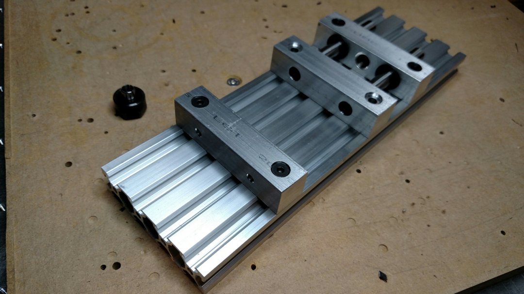

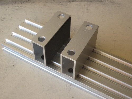

    Sonny, I needed a quick solution for doing some edge drilling and a play on your original design seemed the easiest approach. Just drop in the block, squeeze it together with a ratchet clamp and tighten the screws. The thin adhesive rubber pad on one side gives it all the grip needed.

    Rick,
    I love it, excellent example of how this little vise can be adapted and expanded for some many uses!!! I've cut a couple sample Soft Jaws, but still tweaking my CNC a bit so I'm not happy with the finish yet...hope to have a few real ones this weekend :)

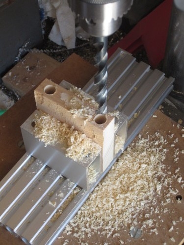

  20. AndyC
    AndyC New
    Feb 13, 2016
    13
    IMG_20171208_211143177.jpg What a nice design. Thanks! I built one today. Works very nice, with the caveat below:
    I made a couple of mods:
    1) tapped the 3/8" OD dowel pins for M5. Put countersunk clearance holes for M5 screws in the slide block opposite the holes for the dowel pins, and put screws through the block into the dowel pins to hold them in. I could have press fit the pins in, but runout in the bridgeport I used made the holes too loose.
    2) Like the discussion above, I also put M5 tapped holes in the stop block (same location as the screws into the slide block). This will allow for attaching replaceable jaws on both blocks, much like shown in the discussion above.
    I found a problem in the Parts List. The specified M10 bolt (91290A220), is a standard 1.50mm pitch screw. The specified Helicoil (91732A809) is a fine thread, 1.25mm pitch. I did not check this carefully before building, ARGH (head-smacking bench sound)! The correct Helicoil is McMaster 91732A800. I did find hex-head bolts with 1.25mm ptich, so I dont have to remake the part; note that fine pitch M10's are uncommon - better to stick with 1.50mm pitch.
