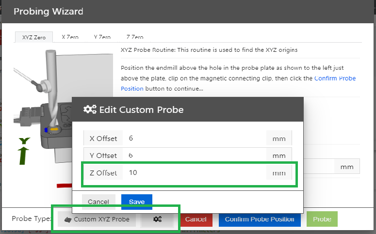

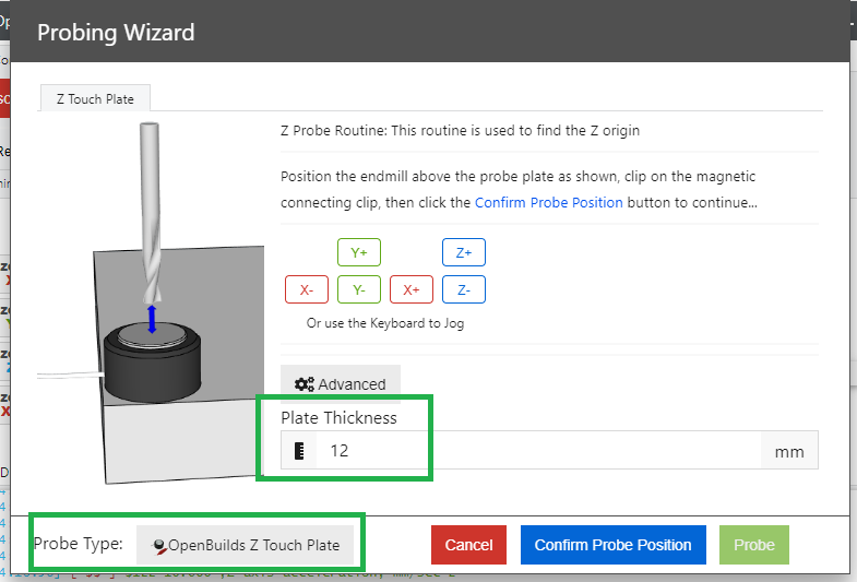

Hello all. I'm using a touch plate that is 3mm thick and wondering how I can change the settings in Openbuilds Control.
If its an XYZ type of probe: Select Custom XYZ Probe under Probe Type, click the Gear/Settings icon button, and set your offsets: If its a puck type Z Touchplate, select Z Touch Plate under Probe Type, and then under Advanced you can set the thickness:
