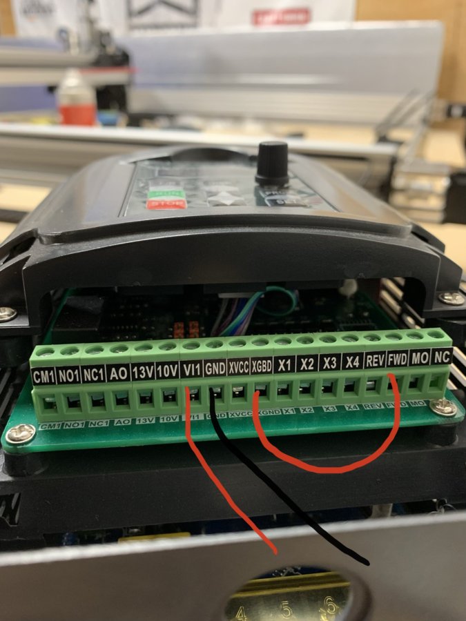

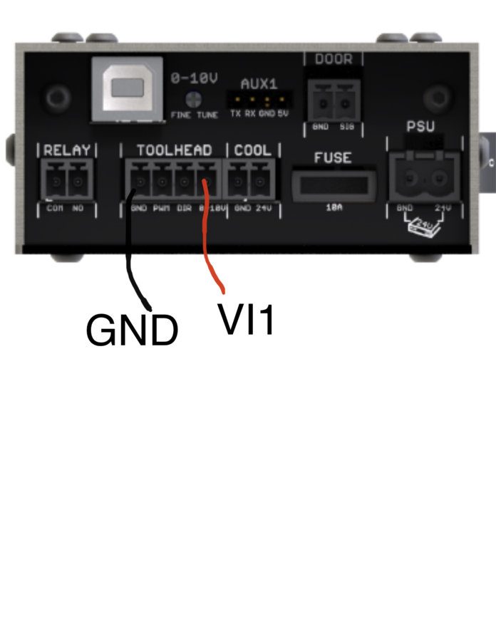

    Hello, I have these exact same settings and the same spindle but as soon as I connect it to Black box the spindle doesn't work. Do you know what could be wrong.
    1. When I use the controls from the potentiometer from the vfd, the spindle spins up and everything all the way to 400 hz.
    2. I am getting 10 v signal to from the Black box and have connected it to V1 port and Ground from the black box boes to GND to the VFD. When I change the speed using open builds I see the frequency change but the spindle doesn't rotate.
    3. i have the same program values as the ones in your post.
    I am kind of stumped at this point and don't know what I am doing wrong. Any suggestions is appreciated. Thank You in advance.
  18. Ryan Matthes
    Aug 18, 2019
    19
    I would check the wiring to the spindle that it’s the correct orientation. Check the spindle with just the vfd. Make sure it works with the vfd. It might not be black box or the vfd settings.
  19. Parth Shah
    Jun 4, 2021
    Do you mean if u,v,w correspond to 1,2,3 on the connector? I was told that the order didn't matter as long as 4 (ground) went to ground and the spindle rotated in the forward direction. And if the spindle is in reverse then I just need to switch any two of U,V,W wires in the VFD.
    So when I just connected the spindle to the VFD with a setting of [P 00.01 to 0] and [P07.08 to 0] so that I can use the controls on the VFD panel. I was able to control the frequency with the potentiometer knob. I think the spindle is hooked up correctly but as soon as I connect the [V1/Gnd to blackbox] and [fwd to xGND] in the VFD and change the program to [P 00.01 to 1] and [P07.08 to 3]. It stops working. When I change the speed from the blackbox controller to M3 S12000 i see the frequency on the panel go to 200 Hz but no movement on the spindle.
