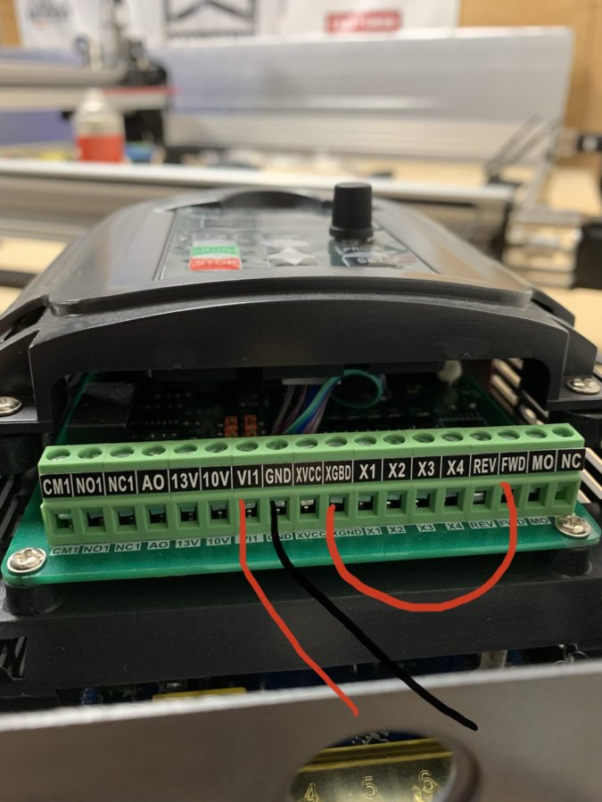

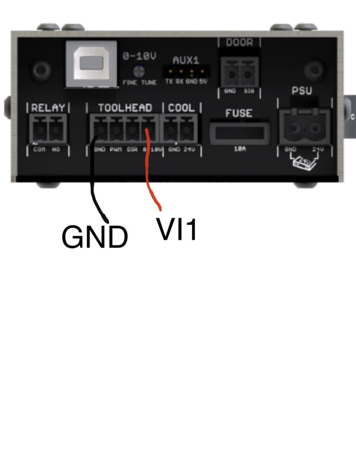

  3. DxN32
    DxN32 New
    Aug 12, 2019
    23
    14
    02DF77B5-DE5B-4293-809E-40E17012F90D.jpeg D105CB6D-A78B-4ABB-9491-F2A028263D2B.jpeg
    and m3/m5 jumper in BB

  8. Mouss
    Mouss New
    Nov 13, 2019
    20
    Hello All,
    I ordered the YL620-A with 1.5k spindle to go with my BlackBox, can your parameters be suitable?
    Thank you in advance.
  9. DxN32
    DxN32 New
    Aug 12, 2019
    23
    14
    yes sir :thumbsup:

  12. Mouss
    Mouss New
    Nov 13, 2019
    20
    Hello All,
    YL620-A VFD 220V and Spindle 1.5kw 400Hz 8A 220V
    I connect exactly as on the photos of DxN32, but when I send the command M3 S1000 or others, I have no change on the volmeter at the exit of the blackbox (OpenBuilds® Documentation /blackbox/#335-0-10v.html) I tried with the jumper on M3 / M5 and without the jumper.

  13. Peter Van Der Walt
    13,751
    4,070
    Psu connected and powered on? BlackBox needs the 24v input to generate the 0-10v output
  14. Peter Van Der Walt
    13,751
    4,070
    Will output 10v IF $30 is set to 1000. If not send S**** where ****=value of $30
    Refer to the Grbl wiki
  15. Mouss
    Mouss New
    Nov 13, 2019
    20
    Hello, yes it is good to supply 24v, here is my installation and config
  16. Mouss
    Mouss New
    Nov 13, 2019
    20
  17. Peter Van Der Walt
    13,751
    4,070
    Remove the relay jumper or move it to M8/9 - else it will click like crazy during PWM settings.

    Is it normal that when I test the output of the BB (0-10v) I only get 4.8v?
  19. Peter Van Der Walt
    13,751
    4,070
    Depends on
    - grbl settings ($30,31)
    - what command you sent
    - did you calibrate the output yet
    - measure without VFD wired in - if vfd causes voltage drop there is an issue with the VFD
  20. Mouss
    Mouss New
    Nov 13, 2019
    20
    Depends on
    - grbl settings ($30,31) -------------------- $30 = 1000rpm $31 = 0rpm
    - what command you sent ---------------------M3 S1000
    - did you calibrate the output yet---------------------------Yes 10v now
    Now works with the VFD not wired and wired, for the BlackBox the problem is solved Thanks for the calibration info,
    I still have to find out why the M3 S1000 command does not start the spindle.

  23. Mouss
    Mouss New
    Nov 13, 2019
    20
    DCM ? sorry for my ignorance ...
  24. Peter Van Der Walt
    13,751
    4,070
    Refer to your VFD manual, might be named something else. DCM usually = DC Ground. FOR usually = Forward Enable (but each vendor names them a little differently)
    Refer to post 3 in this thread YL620-A VFD Settings
  25. Mouss
    Mouss New
    Nov 13, 2019
    20
    Yes, I plug in exactly like DxN32
  26. Peter Van Der Walt
    13,751
    4,070
    Then should just be case of parameters. Either work through the manual, and examples above (top of this thread) or ask your VFD vendor for advice
  27. Mouss
    Mouss New
    Nov 13, 2019
    20
    now I can hear the click of the relay when I turn on (Tool On) and (Tool Off) of Openbuilds Control, but the spindle does not spin, I will find :)
  28. Peter Van Der Walt
    13,751
    4,070
    Relay isn't used with VFD. Move the Relay jumper off M3/5 for VFD else intermediate PWM (s-values) will make the relay wear out as it chatters according to the PWM setting.
    Refer OpenBuilds BlackBox 4X Documentation
  29. Peter Van Der Walt
    13,751
    4,070
    Might be the most relevant, but havent had one of the VFDs myself.
  30. Mouss
    Mouss New
    Nov 13, 2019
    20
    Thank you so much
    I modified some parameters in the VFD and now I can control everything from Openbuilds Control (perfect) I just have to find the right setting for the speed of the spindle, because in aspire vectric I have to put on the 500 rpm tool to have 12000 rpm for example, it must be a multilicator to modify.
