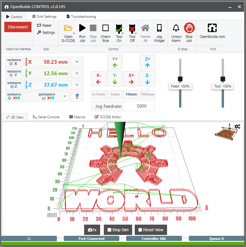

    Hi,
    I'm using the sphinx 55 with the xpro V3, and i'm trying to figure out how to retrieve the current xyz coordinates.
    I've tried M114, $? and ? to no avail.
    What am I missing ?
    14,871
    4,283
    '?' will print the current postition. In a terminal at least. Which host software are you using, if you use OpenBuilds CONTROL (software.openbuilds.com) you dont even have to send anything, we display it right there in the DRO (Digital Readouts) (top left corner above 3d viewer)

    Thank you for your response.
    in CONTROL '?' wasn't doing anything which confused me, but i noticed that in a normal terminal it was indeed printing out:
    <Alarm|MPos:0.000,0.000,0.000|FS:0,0|WCO:-290.000,-42.998,-321.999>
    Do you have any tips on how to filter out just the positional data?
    Also, I noticed everytime i reconnect to the serial port that the positional values jump back to 0, is there a way to change that?
    14,871
    4,283
    Disable AutoReset on your controller (Hardware) - When USB connects, it resets the board.
    We parse it in JS, you'll have to elaborate on what you want to do, but basic programming skills will suffice, position finding, a little Regex, etc:
    See OpenBuilds/SW-Machine-Drivers
    Its intercepted by the parser above to show it to users in a nice pretty GUI with flashing alarm icons, modal error messages and all the other eye candy that counts
