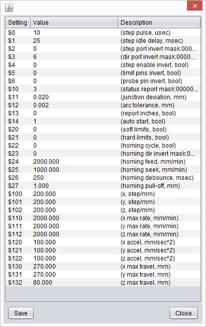

    Hi,
    I have a C-Beam Machine with xPro V3 Board. I have downloaded the latest GRBL Rel. 1.0.9.18A installed on my Windows 7 Laptop. I have got connection to machine through USB Cable but I don't see any settings in the GRBL Settings window. I tried to click on "Get GRBL Setings" button but nothinghappens. What's wrong and how to fix it? GRBL Settings Lost_23122018.jpg

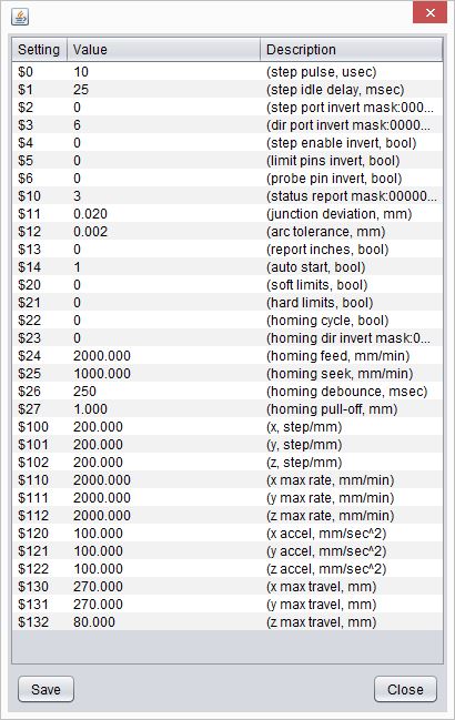

    Hi, I don't have any settings shown on the "GRBL Settings" window even when I am connected via USB Cable and I click "Get Grbl Settings". Below is the screenshot of Sample grbl settings I had before.
    Does it really matter if I use GRBL 1.0.9.3 or GRBL 1.0.9.18. As a matter of fact I have tried both.

  7. MHSB
    MHSB New
    Jun 14, 2014
    Hi Gary,
    Yes I have loaded the X-Pro Driver on my Laptop (Win7) and now I am connected to the machine (C-Beam Machine). Below is the screenshot of the current connection and "Grbl setting". Now, I have no movement taking place when I try "jogging" in X,Y or Z direction.

  8. Peter Van Der Walt
    13,998
    4,110
    $4 should be 1 (If you have one of the newer V3 XPROs)
    See Spark-Concepts/xPRO (the comment "
    (Board V1, V2, V3 Matte = $4=0 - Glossy board V3 = $4=1)
  9. MHSB
    MHSB New
    Jun 14, 2014
    Thanks Peter! it worked.
  10. MHSB
    MHSB New
    Jun 14, 2014
    Hi Peter, I have another issue to discuss as follows:
    Using the GRBL Panel (or Openbuilds CONTROL), when I jog my C-Beam machine in X or Y direction for 100mm it travels 99mm (297 instead of 300mm). I checked it using a steel ruler. What shall do to calibrate the machine for correct distance travelled?
  11. Peter Van Der Walt
    13,998
    4,110
    OpenBuilds CONTROL > Grbl Settings > Scroll to offending axes' steps per mm > Click Fine Tune. (theres a calibration wizard in recent versions)

  13. MHSB
    MHSB New
    Jun 14, 2014
    Thanks!
    I remember my original GRBL Settings for $100/$101/$102 were 200.00 and currently they are 199.100.
    I will try to bring it back to 200 and see the results (Will do fine tuning if required).
