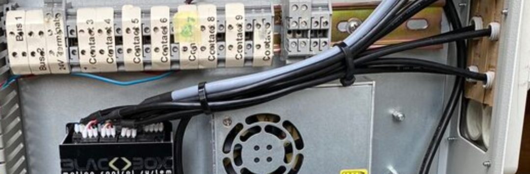

    The terminals on the DIN rail here: Running mains in them? AC cabling near the low voltage signal cabling may still induce EMI

    The contact on the din-rail is used as a cable-extension, so that shouldn’t be a problem. However, there is mains running on top of those, so I will separate those. I did the 10mm acceleration with homing too, which didn’t solve it. I will make the sign in wood too!

  22. David the swarfer
    3,408
    1,899
    You have bundled the limit switch wires with the stepper motor wires. That is mixing low voltage (sense) wires with high current power wires, a recipe for EMI.
  23. David Kater
    Feb 4, 2022
    67
    Would removing the zip-tie and spreading them out a bit be enough?
  24. David the swarfer
    3,408
    1,899
    yes, maybe, probable (-:
    'as much as possible' rather than 'a bit'
    wire spacing is subject to inverse square laws, double the distance gives 1/4 the field strength, so every bit counts.
    if they can also be 'not parallel' then that is much better.

  26. David Kater
    Feb 4, 2022
    67
    F3C8A493-8976-4955-9697-1780F85E6EC7.jpeg A9A79711-A1E6-49A5-A5A3-CB6CD829D388.jpeg This is how I have got the wires running now, still the same problem, but I don’t have much more room to spread them further
