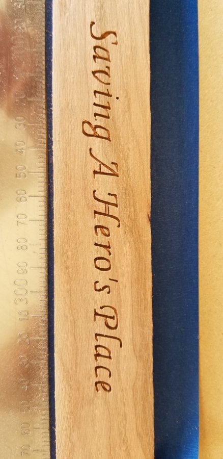

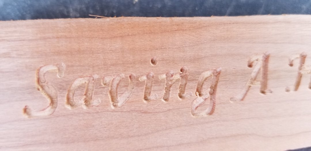

    20190902_165911.jpg 20190902_155841.jpg Need some help. Tried cutting this file with 2 different bits. One cut is with a 60 deg v bit and the other was done with a 15 deg engraving bit. I hope you can see it in the attached pics but the sharpness I was expecting just isnt there.
    Anyone have any suggestions or more info needed?

    Specifics of your machine? Belt or lead?
    Looks like backlash in Y (loose coupler on leadscrew, loose lock collars, or loose setscrew on pulley on motor)

    Workbee 1510, belt driven. I had just check set screws on both Y motors, along with their respective belts.

    I noticed what looks like a bit of backlash but maybe not quite it then. You mentioned "the sharpness I was expecting just isnt there." - not sure I 100% understand then, what exactly bothers you? The little leftover islands like inside the E and P of the right side cut, the fuzziness of the wood fibers (Router RPM of bit sharpness) or something I am not seeing immediately?

    I'm assuming the clear stuttering and tearout is the problem. In which case, the usual; sharper tooling, lower feed, higher speed. Any lash seems to be more of a product of the tip digging in due to zero effective tool speed at the tip; using a rounded-end V-bit- usually called a tapered ballnose, I believe- would probably help with that too. Polished flutes, HSS instead of carbide, whatever it takes to get the edge sharpness, but tool life will be reduced to gain surface finish.
