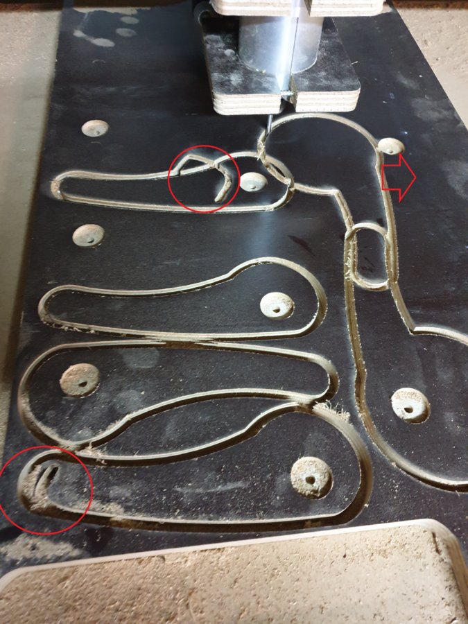

    As a test I have tried to execute the attached file who looks correct when I in NC Viewer // GCode Viewer and Machine Simulator
    But the result is really really strange I had to stop this test!
    What did I have done the wrong way?

    Hi Benjamin, I have looked at your G code file and there are some aspects of it which look a little odd. Could you please let us know what software you used to create this? (G17 is not recognised by the Duet, M3 turns your spindle on, but your machine is not set up to use this. The feed rate at 3600 is very high.

    @Alex Chambers This code have been generated by Aspire. I didn't really have investigate the best cnc software for woodworking yet. I am use to use Sketchup but the cnc plugins are not very good in my opinion...
  23. Alex Chambers
    2,730
    1,332
    What post processor did you use? - it should have been this one; GRBL (mm) (*.g-code)
    There is also a T1 call in your g code - an instruction to use tool number one, which the workbee doesn't need.
    There are also no arc codes (G2) which the Duet can support - your code is all straight lines.
    Alex

    I don't have any vectric software (can't afford it) so I was a bit puzzled by those bits of g-code I mentioned, and I am surprised that vectric doesn't do arcs. As the file ran those codes must have been ignored.
    Having said that I don't think the g code was the cause of your problems with those P clamps. I assume that you used the Duet Web Control to upload your g code file and run it?
    From the picture it looks as though two of the p clamps are bigger than the others, but they don't seem to be in your g code. EDIT - just looked at your g code in a simulator and those two are bigger.
    Is your router cable well away from any other wiring?
    Given the problems you have been having I suggest not asking your machine to work too hard - reduce the feed rate to 2000 or even 1000 and use a router speed of 19000/20000 - 3.5 on the Makita speed dial.

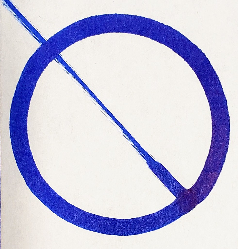

  26. RV6APilot
    RV6APilot Well-Known
    Apr 23, 2019
    29
    23
    After going through and tightening screws and correcting the backlash problems I have a circle. It measured 50mm diameter as it should. The couple of small abnormalities are due to me
    smashing the Sharpie head into the spoil board and the fact that I have it mounted in my spindle and it rotates as it draws. Let me know what you all think and thank you again to @Rob Taylor and
    @Alex Chambers for their suggestions.

    but on the bottom left it was really as if he "forgot" to move up the router before moving - that and the mis-positioning of the two clamps on the right was why I suspected interference
    -> What is the purpose of those changes wht did they do that? Does it have an impact of the g-code product by my CAM software? - most hobby cnc machines use the grbl subset of g-code. The Duet uses the rep-rap subset (developed for 3D printers as was the Duet) It shouldn't have an impact on your g-code as long as you use a post processor that has been written for the Duet - you are correct to follow the recommendations on the Ooznest site. I think the reason why Ooznest use "non-standard" machine and workplace co-ordinates is because the way the Duet used G53 was a bit odd to start with (I believe that may have changed now)
