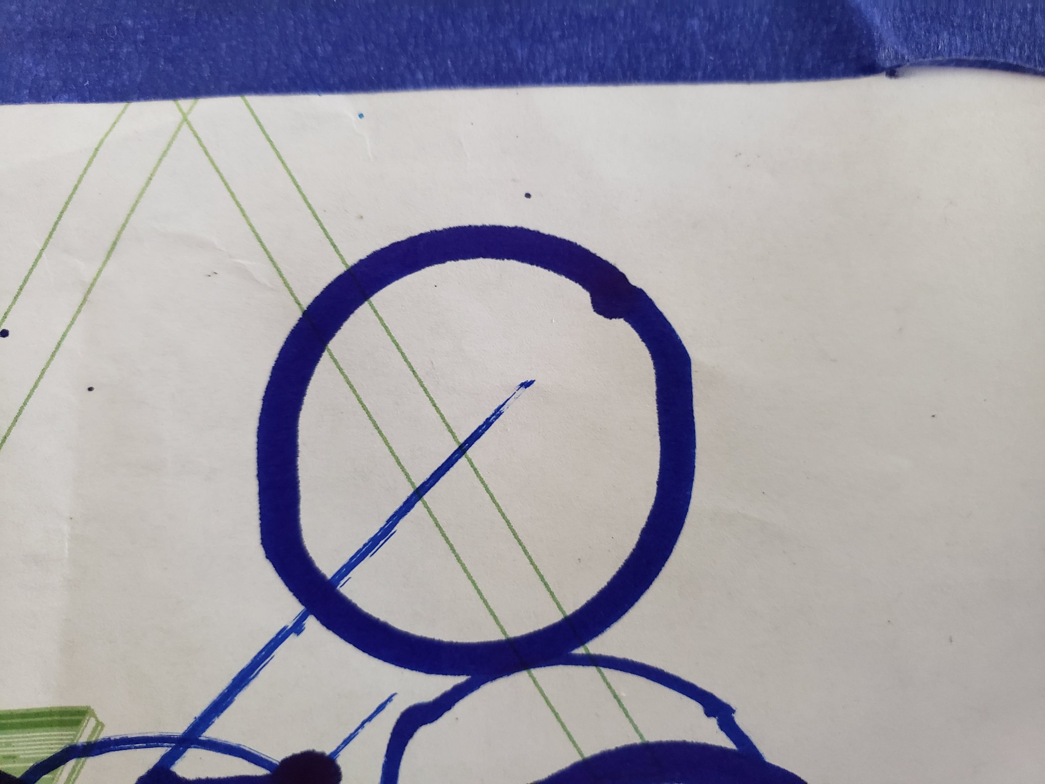

    Apr 23, 2019
    29
    23
    Well, I am pulling my hair out like many. I tried using a sharpie to do the Hello World and it was a disaster so I thought lets try something simple like a 50mm diameter circle. Wow.. did that show how out something is. I have checked my connectors and verified they are tight and that each y axis is moving exactly the same and that there was no binding on the X axis. When I told the X axis to move 100 mm it actually move 98.425mm. I am using the standard 1040mm Tr8*8-2p (4 starts) Lead Screws. I have literally torn this thing apart and put it back together and it still prints the same. Does anyone have any ideas? Here is the circle that was created in
    OpenBuilds CAM - GCODE Generator.
