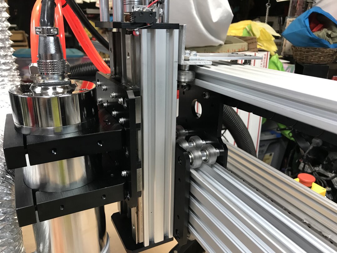

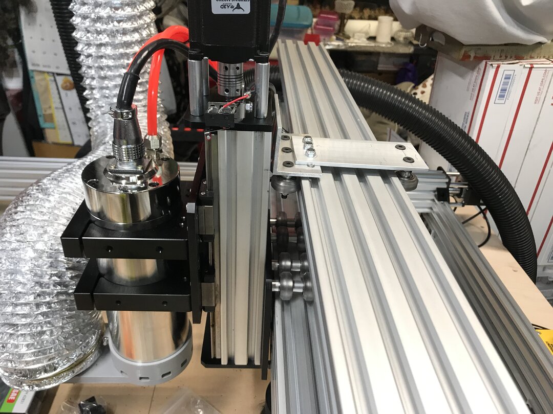

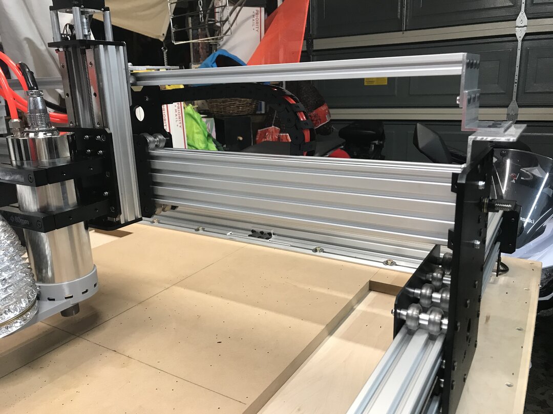

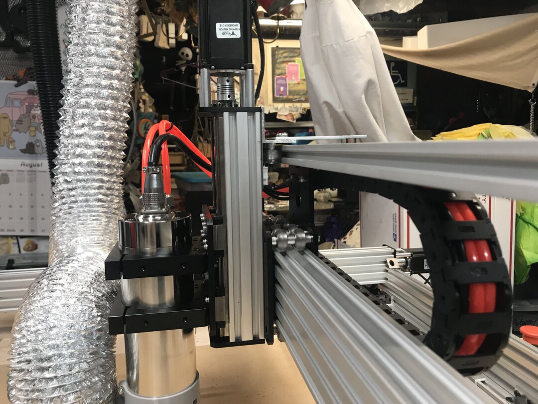

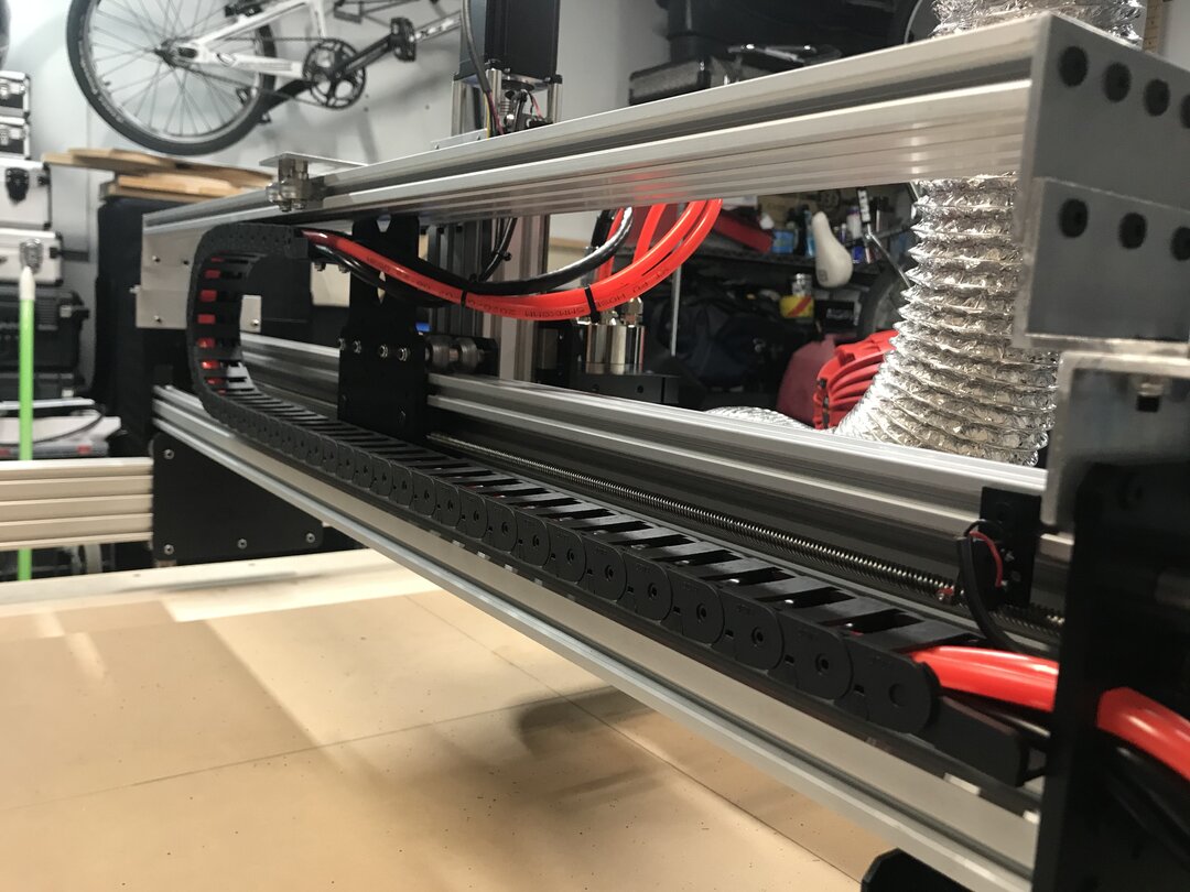

    I realize this post is getting quite old, but having recently gotten into CNC routers, I figured I would chime in with my experience and solutions.
    I acquired a Workbee 1000X1000 unit with a 2.2kw spindle and the higher torque motors. Overall this unit is very impressive considering its price point and simple design. I had it built, tested, and ready to cut parts in about 3-4 week's time. This includes having to order a new motion controller and a nearly full redesign of my control box layout. I ended up getting different stepper drivers and therefore needed to add some power supplies onto the board. In the end, I had a very trouble-free, quiet, and what I would consider being a fast machine for the money spent. I have a top speed of 150ipm in any given axis and the way I laid out the machine I have a full 5 inches of usable z-axis!
    The problem..... I too noticed a considerable z-axis deflection. This was slowing me down, causing issues with some parts, and really just bothering me. Just cutting air I could see the Z-axis bouncing with some of the G-Code I had loaded! I machined an AR15 80 % lower and this is where it really started to show signs of weakness. While I was able to cut a clean and rather accurate part, it was not without the gritting of teeth. I then cut some small steel parts that caused a lot of chatter and bouncing of the z-axis that really just annoyed me. The part came out fine and usable, but it was time to address the z-axis.....
    I set my machine up with a moving axis as per the instructions. I thought it to be a little weird at first seeing as it added a ton of weight for the z-axis motor to have to move and no matter which way it was mounted, it was going to be a pain to remove and work on. I decided the first thing I needed to do was go with a moving spindle type design to reduce the mass that the z-axis motor would have to sling around which should help with some of the bounce and help add a minute amount of rigidity. After doing this I saw where the heart of the problem was as it was now much easier to see where all the deflection was coming from! The V-Groove wheels had quite a bit of movement before the x-axis started to give. It was not as obvious before when there was deflection in the z-axis gantry, the wheels, and eventually the x-axis c-beam. I quickly decided to go to a linear rail mounted z-axis! This is the ticket to a smooth, accurate, and stiff z-axis.
    So after getting the linear rails attached and the z-axis sorted out for the spindle gantry, the next area that became obvious where deflection was occurring was in the spindle mount itself. So time to add a second mount. After adding a second mount the z-axis was as stiff and rigid as you could expect! The deflection was now evident in the x-axis bearings and c-beam..... At this point though, the deflection in the z-axis is just about half or less than it was originally and I hadn't really spent too much money. A spindle mount and the linear rails were about $100 or so all in. I figured since I had gone this far I may as well go for broke.
    The way I set up my machine, I ended up having an extra 20x80 beam that would have been used for the base of the machine. I decided it would be the perfect tool to use as another rail to stiffen the x-axis gantry deflection. I am mounting it so that it lays flat just above the x-axis gantry. I made a bracket that will connect to the top of the now stationary z-axis gantry with V-Wheels that ride in the slots in what would be the front and back of the Y-axis direction. When the x-axis moves side to side, the beam, independent of the x-axis and z-axis gantries, will act as direct support to reduce flex and deflection from the z-axis forces, and the x-axis motor should only have to move another couple ounces from friction and weight of the added bracket and V-Wheels. Since a picture is worth a thousand words and I have written so much already, some pictures have been attached to hopefully show what I mean. Thanks for your time and I hope everyone is well.
    For the edit: I hadn't exactly finished this project when I posted this. I completed it today and am at this point satisfied with the result. The 20x80 beam on the top did its job extremely well; so well in fact that it is now the lower part of the x-axis C-beam that is deflecting now. I do not feel inclined at this point to try and stiffen things any further. The deflection that does occur is about 1/4 or less of what it was originally and it requires some dedication to do it. I feel a cutter running through wood should not have a problem. Metal may still be, but I should at least be able to do it with less bounce and chatter.
    One plus to this particular design is that you could use the upper beam as a pre-load system for the z-axis to help in tramming. I did not use it for that purpose and set it so that it was in neutral tension. I have some shims ( feeler gauges ) that I used for that. Anyway, take care everyone and I hope this helps.

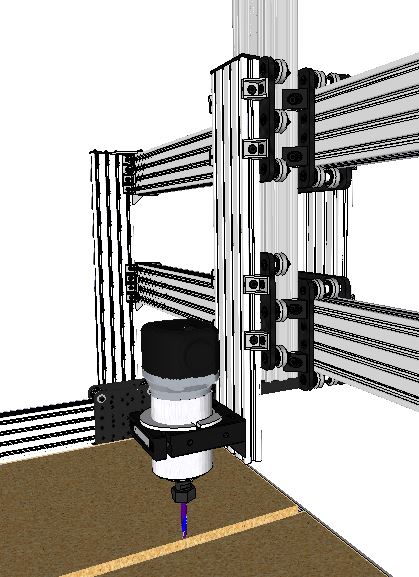

  26. Rick 2.0
    2,861
    1,528
    I would suggest adding a second gantry plate to the axis and a carrier rail to bring the spindle down. The upper Z plate will reduce the leverage that would exist on the wheels on the lower plate thus making it more rigid. Upper Z plate should not be attached to the Z-axis lead screw. The carrier rail will allow the spindle to reach down without overextending it within the mount.
    Note: this is all about using leverage to your best advantage (or more specifically, not allowing the machine to use leverage against you). Keep the bottom of the fixed Z-axis beam and the lower X-axis beam as low as possible. Provide good spacing between the upper and lower X-axis beams and good spacing between the upper and lower moving Z-axis gantries. And the low moving Z-axis gantry should be near bottoming out at the bit reaches the spoil board.
    Rough Sketchup model attached. It should be considered in concept only and is not dimensionally accurate.
    It should be noted you are pushing the limits of what an aluminum extrusion based system will allow. Don't expect miracles. These systems will never match the capabilities of steel framed systems costing many time more.
    GKTRK likes this.
