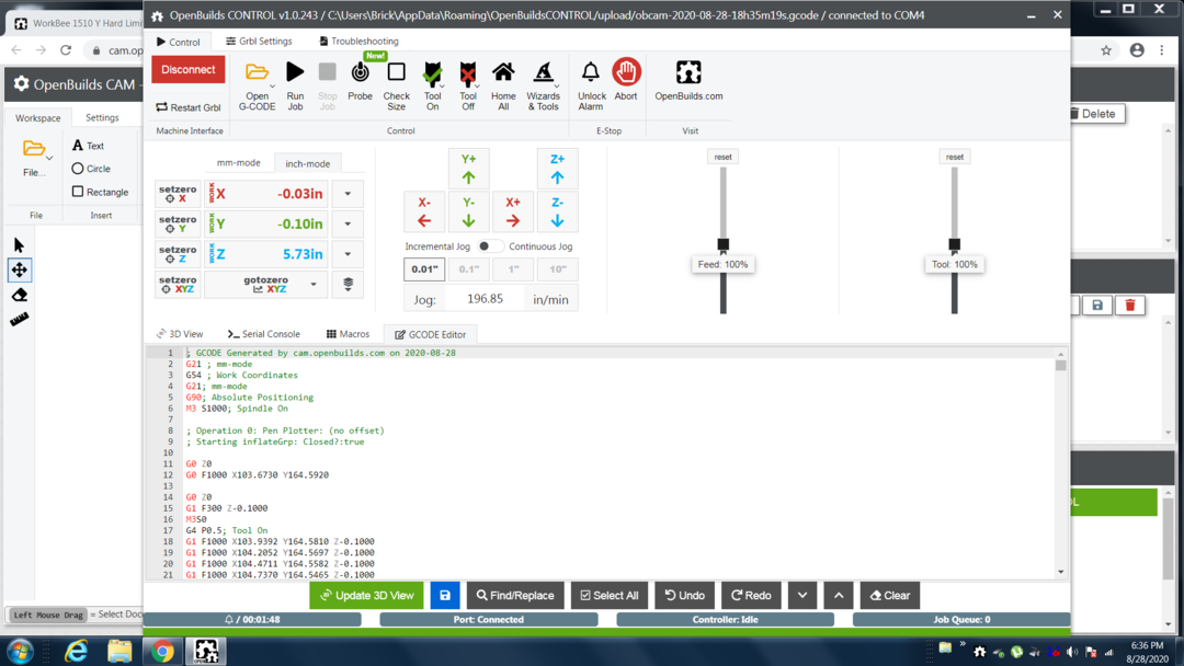

    Peter,
    I attached several images the last one is the image pulled into control giving the g-code operation serial console reading etc. Hopefully you can see the problem and advise me how to rectify it.
    Home settings work fine, its when I select run job the Y axis goes toward the switch till it hits causing the hard limit error; at the same time Z axis comes down toward the zero setting, X axis goes toward the switch......if I move Y axis away from it hitting the switch...X axis switch is hit. All axis have zero settings. I have ran this same drawing several times with no problems till this last upgrade and lost the Grbl setting to the WorkBee 1510. I just don't see the error in the code to be able to fix the problem. Not and expert on the code settings trying to learn as I go. I have yet to actually cut parts out the drawings have to be precise so its back an forth til I achieve the size. I have several drawings made but holding up on cutting out the parts for assembly.
    Bobbolink, Yesterday at 7:50 PM

    Have they done away with the Xpro v4 controller board. I was going to order a new one to replace the one I have in case its corrupted some how; but every where I have search it says out of stock. Openbuilds does not show it listed anymore.
    I am still having the same issue when engaging the run job. To keep from getting really frustrated with this situation I took a break from it. Seems like every thing I try it back fires. Also see that you cannot read the files I sent you. Will try again in a little bit.

    Have a dumb question, at the bottom of Openbuilds control page there is a send icon, is it possible to send the serial console page to you by that route?
  5. Peter Van Der Walt
    13,988
    4,107
    No, that "sends" the command you typed into the terminal to the left of the button, to Grbl. Its used for manual command inputs
    To get the text from the log, select with mouse, ctrl+c to copy, come to forum, ctrl+v to paste (standard computer stuff, copy paste works same in every application)
    Regardless, refer my advice in the other thread:

  7. Bobbolink
    Bobbolink New
    Jul 25, 2019
    29
    These are the serial console settings before any thing ran.
