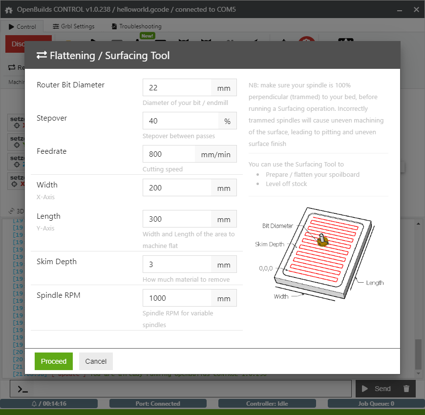

    Hello, I'm wondering why most of the CNC build used MDF instead of OSB board.
    OSB is stiffer & a bit cheaper (at least in europe) and lot more green.
  2. Rob Taylor
    Rob Taylor Master
    Dec 15, 2013
    1,470
    746
    OSB is cheaper here too, but MDF is flatter, more uniform for cutting into, and better helps absorb vibration than a more rigid material.
  3. Peter Van Der Walt
    14,701
    4,249
    Although MDF is better, OSB/Ply works fine too. Just remember to run a surfacing job on it. For the price difference around here, I can get Shutterply (lower quality ply) for about half the price of MDF of the same thickness, so instead I can bump up to the 25mm or 32mm sheet (instead of 19mm) and still save money. I use mine as a proper spoilboard (screw stock down into it, cut through etc) so cheaper means less guilt when it comes time to replace it (about once a year or more)

    MDF is consistent. MDF is probably the most consistent disposable material ever made. MDF can also be used for a pass through vacuum table if you go with the lighter variant.

    I use particleboard. It is also consistent and nearly half the price of MDF. But, I am thinking of doing my next top layer of spoilboard as OSB.

    why it the RPM in mm in the screenshot? It doesn't make sense!
  9. Peter Van Der Walt
    14,701
    4,249
    Haha good catch. Just cosmetic will fix in next version
