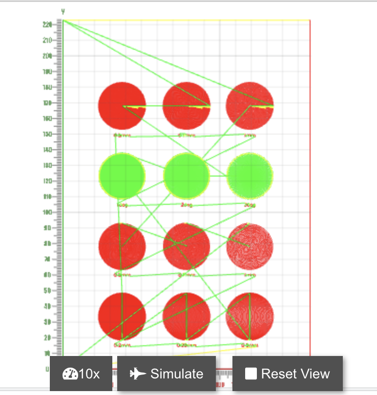

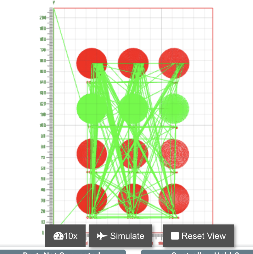

    And good to know about the closed paths. This must be why it was having so many problems—I almost have no closed paths. Although CAM did fine and was super quick with a complicated file full of line segments that I used for the test.
    Attaching the two screenshots comparing CAM processed gcode versus the vpype-gcode just because I found it interesting.

    Rather than a select-all approach, you can control the order of operations easily by creating seperate toolpaths per entity :)
