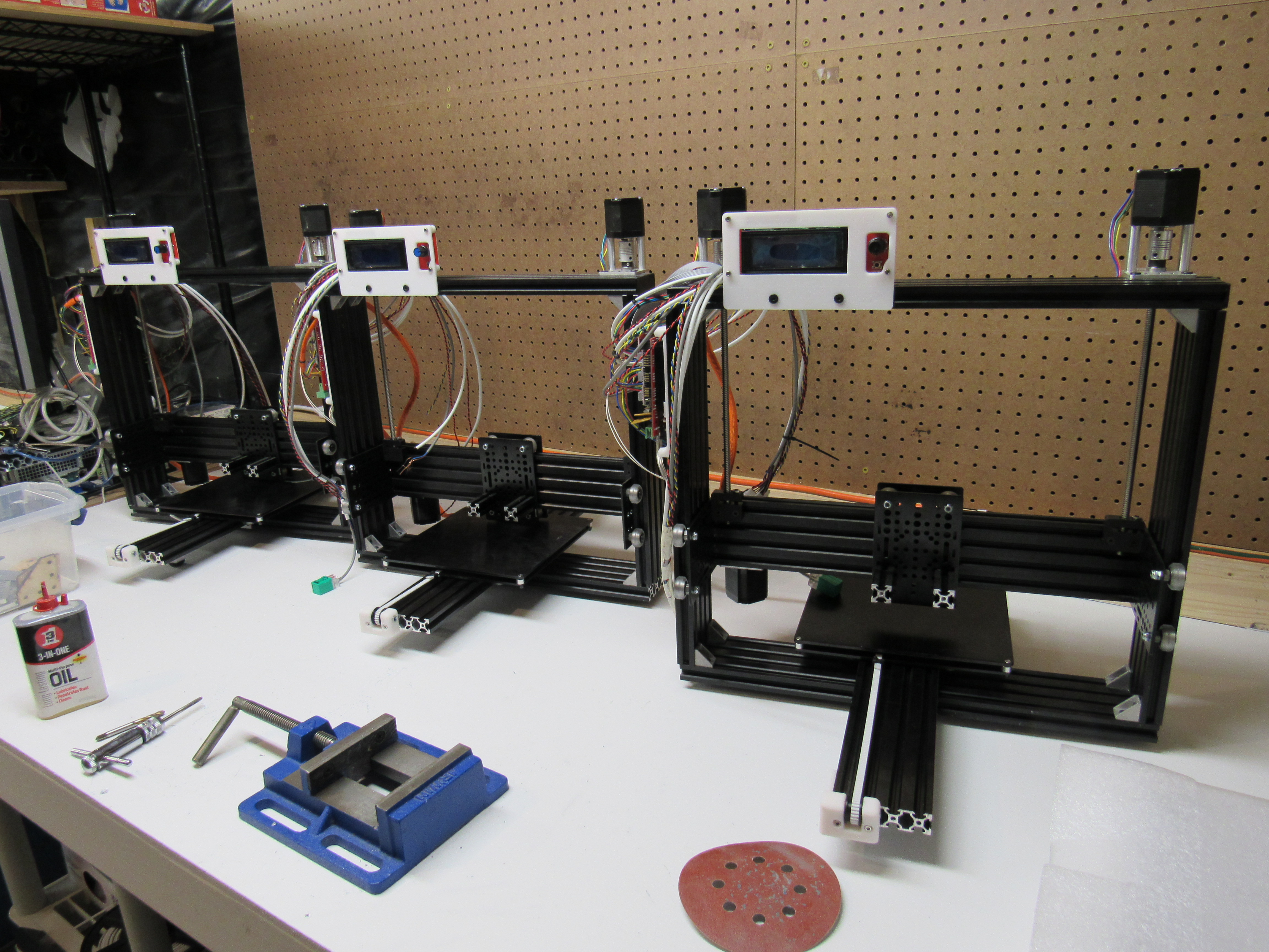

    It's so cool seeing everybody's builds. I'm truly honored. Check out our three amigos!
