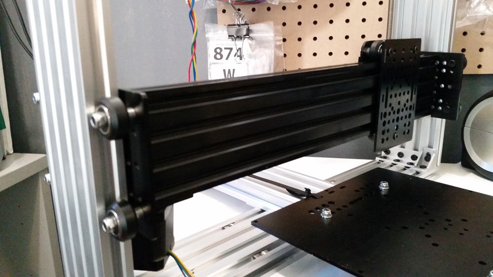

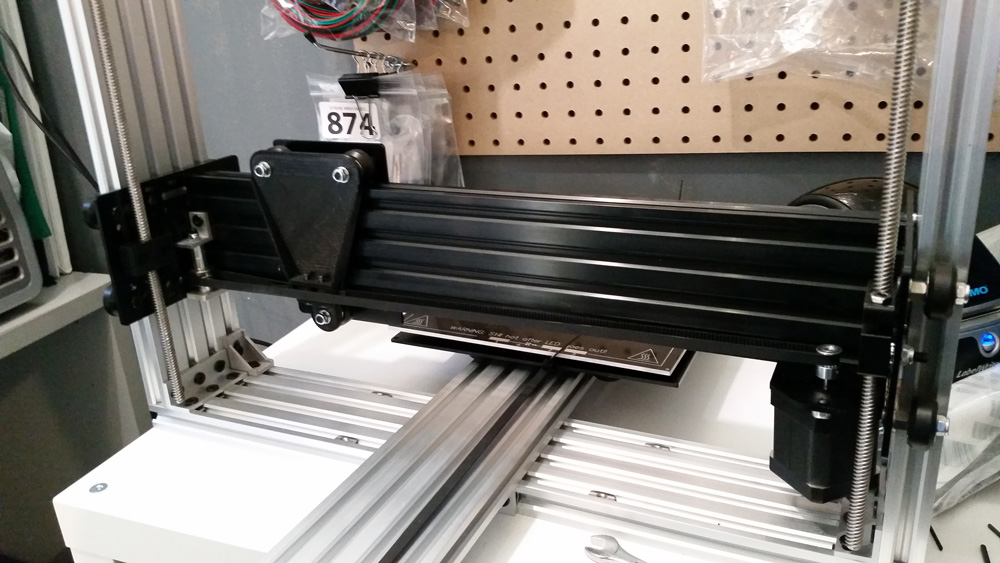

    Very nice! I plan to eventually modify my voxel ox into this setup. I opted for my Z screws to go at the sides though, similar to a previous build on here and at first glance I couldn't find a closed loop belt with the dimensions I need. This is my first 3D printer though, so I will probably revisit the idea once I've smoothed over my current printing issues. Out of interest, what size is the belt you are using?
    On another point, Absolutely loving this printer. I've had minimal issues in setting it up, which is in no small part to its brilliant design. The only issues I've had have been made by myself to be honest where I have tried to skimp on expensive openbuilds parts. Unfortunately we pay a hefty shipping rate in the UK to get V-slot and simple things like the wheels soon becomes one of the greatest costs.

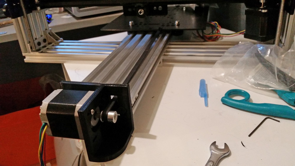

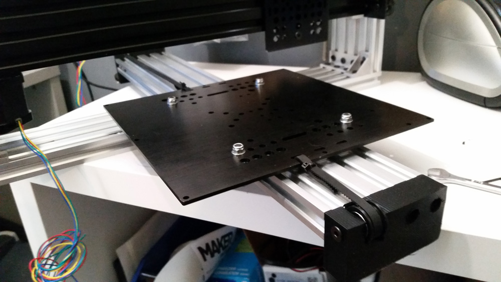

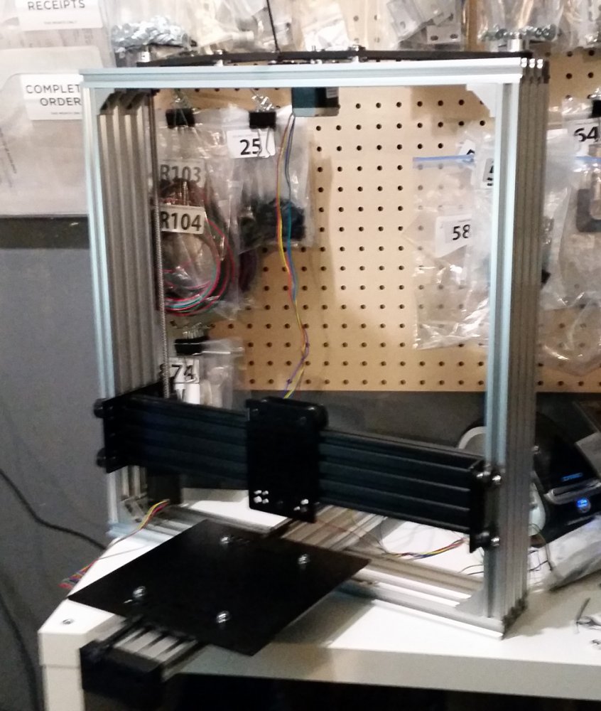

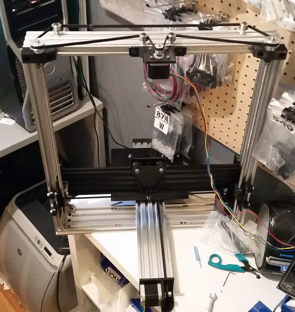

    I havent finalized the size for the closed belt yet. I will likely add one more idler to help tension it.
    Robotdigg sells many sizes of gt2 belt loops

    Nice work! That's a pretty fancy single stepper used for z setup. I always opted for 2 motors because it always seemed end up cheaper and / or easier.

    I have run into binding and out of sync issues too many times with dual Z motor. thats why id prefer to go down to one motor. also this way I have a 2:1 ratio with the gears on the Acme lead screws vs the Stepper to help resolution / torque

    Binding issues... hmm. Are you loosing steps? There should be more than enough torque with Nema17 motors using either A4988 or DRV8825 stepper drivers. They'll need to have current turned up a little more for driving 2 of 1 driver of course.

    most of the time. its fine. but often with microstepping the steppers are not moving full steps, and one might miss a step once in a while for some reason. these errors slowly starts to build up.
    and you need to realign the Z's to get the X Gantry Level again. this is also a problem if you need to manually lift the Z with power off. and you are turning two motors manually.
