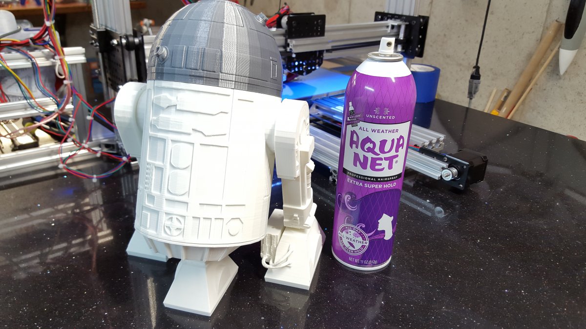

    I'm a little bit slow with posting new pictures, but our friend Hans' (aka thehans)Voxel OX he built printed all of his recent makes on thingiverse.
    Check em' out here:
    thehans's Thingiverse Profile

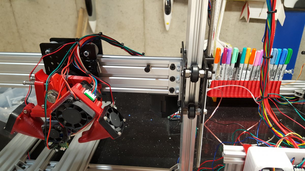

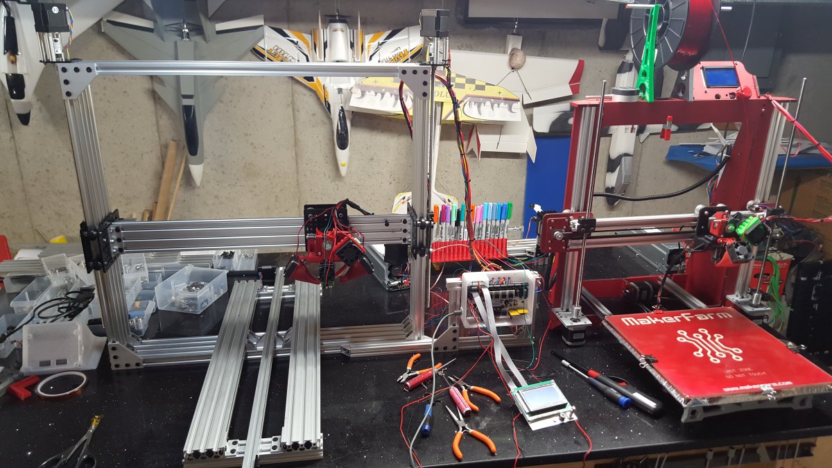

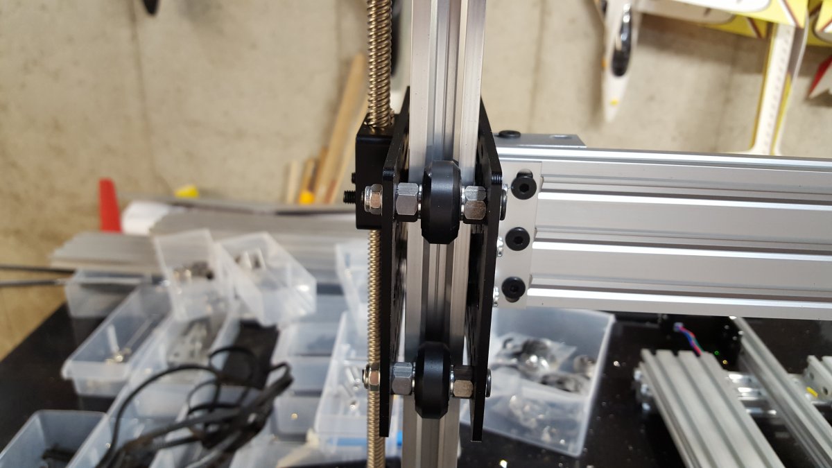

    20160113_204007.jpg 20160113_203827.jpg 20160113_203936.jpg 20160113_203757.jpg 20160113_203915.jpg 20160113_205240.jpg 20160113_203925_001.jpg 20160113_203833.jpg 20160113_203853.jpg

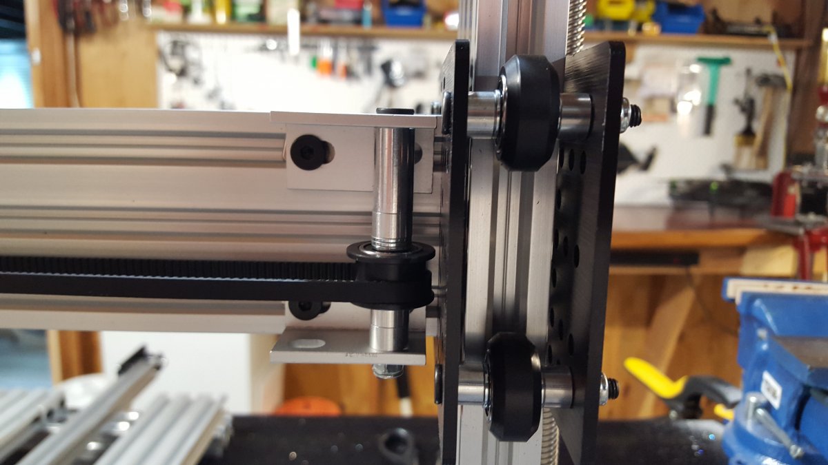

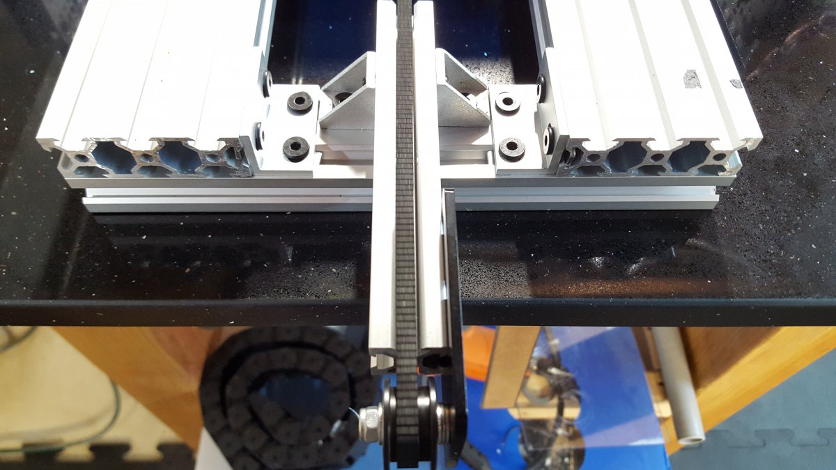

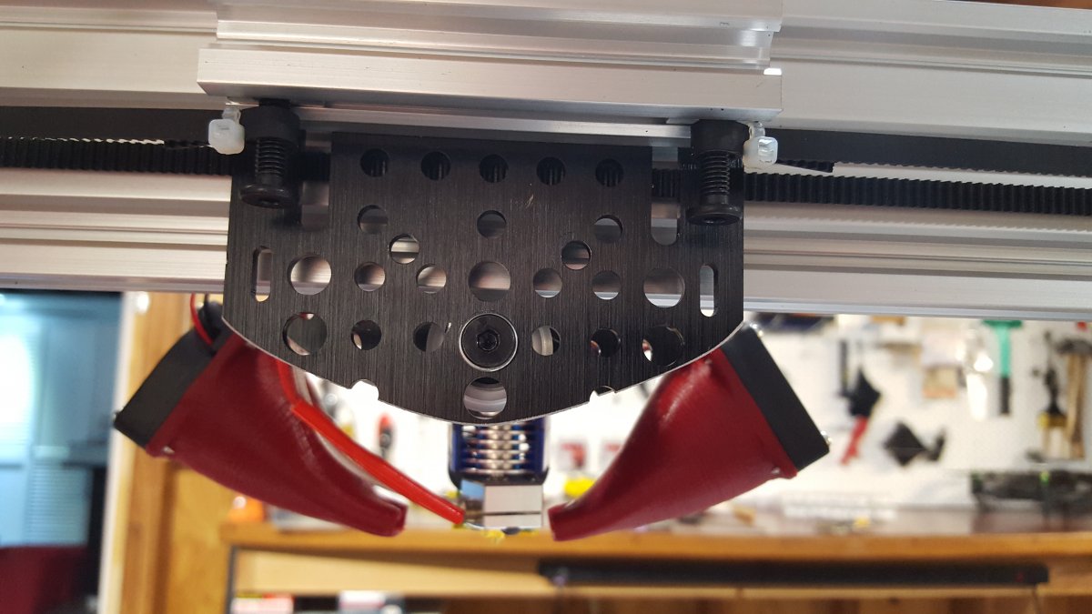

    Hope its ok, but I decided to share some pictures and changes I made to this design.
    Compared to my Makerfarm 12" i3V, its much larger. Its set to print a volume of 400mmx400mmx400mm.
    Take a look and see what you think. The most notable change was to move the z axes to the sides, off of the x carriage to avoid z banding.

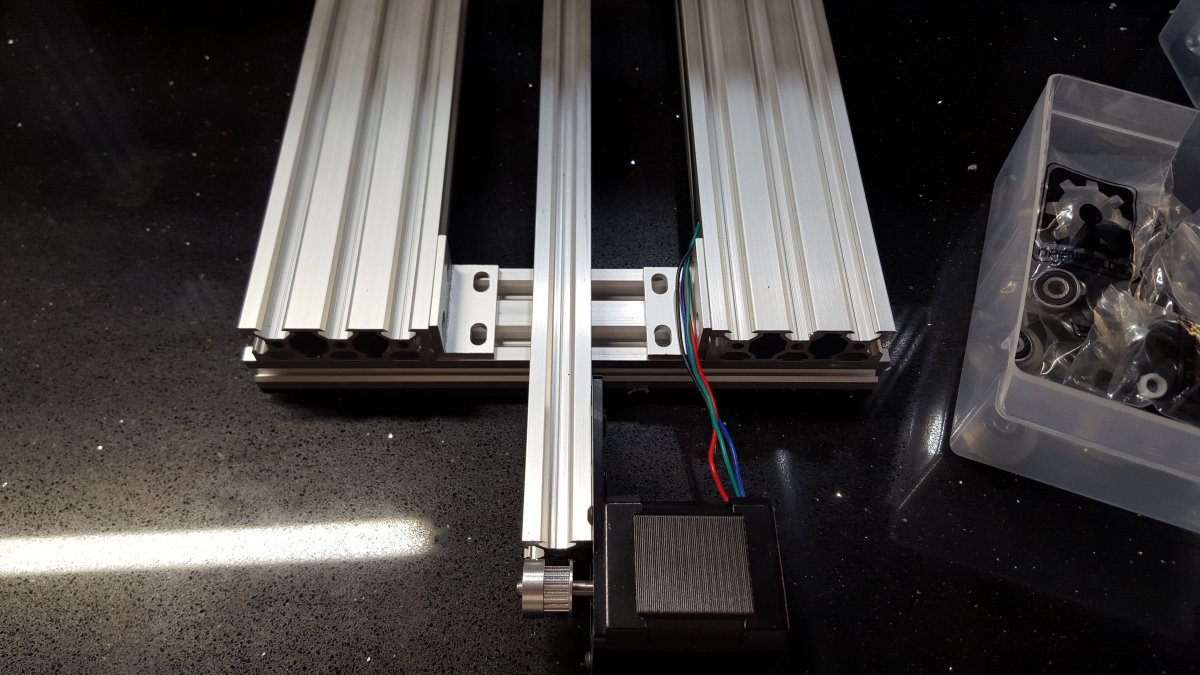

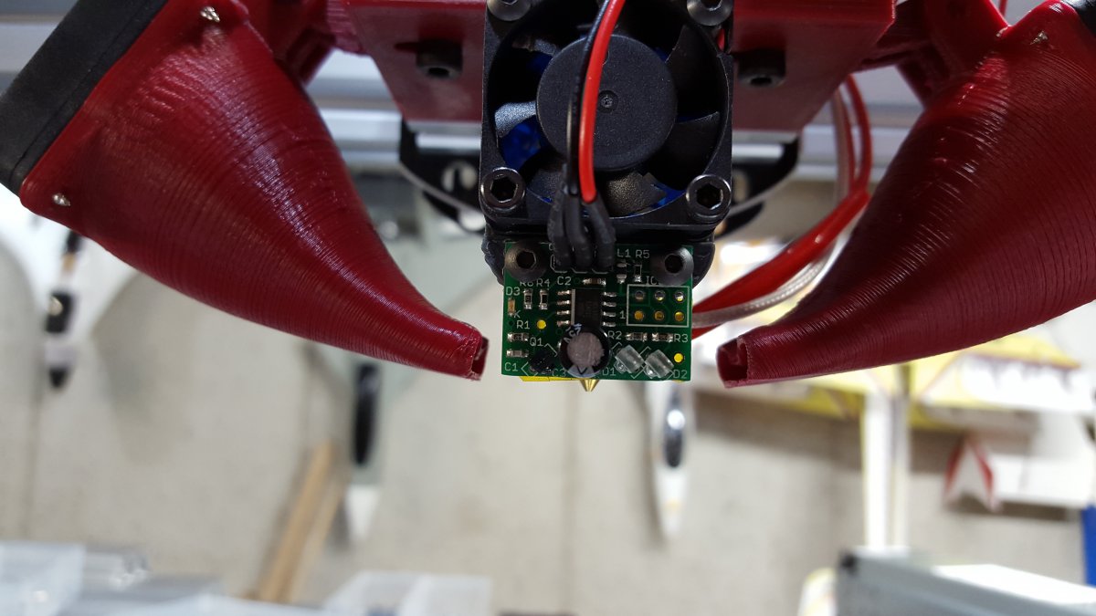

    Been doing some re-tooling too. thehans brought over some slick 12v LED strip quite honestly, was a much overlooked asset. Also, a new sensor mount that uses a flexture rather than the silly springy thing I devised so so long ago. Here's the link on the probe mount. Should work on a lot of printers.
    Z-Probe Mount w/ fine adjust flexure by thehans
    Here's some pics of a new variant I just put together this evening. May call it... Voxel OX-c or something like that.
    cool to see other people's iterations!

    Great design! I don't know if I'm missing something, but I was looking at the cad files and couldn't seem to understand how the 2020 pieces attached to the X gantry plate for the universal extruder mount.
    I plan on building one of these soon!!
    Thanks!
  7. Marshall Peck
    Marshall Peck Journeyman
    Oct 18, 2014
    29
    71
    The short 20x20 pieces that hold up the extruder?
    They're tapped on the ends and screwed in with 8mm or 10mm m5 low profile 2 holes above the the wheels.

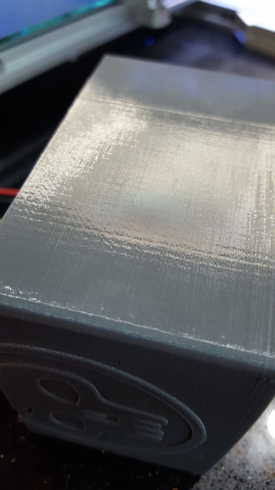

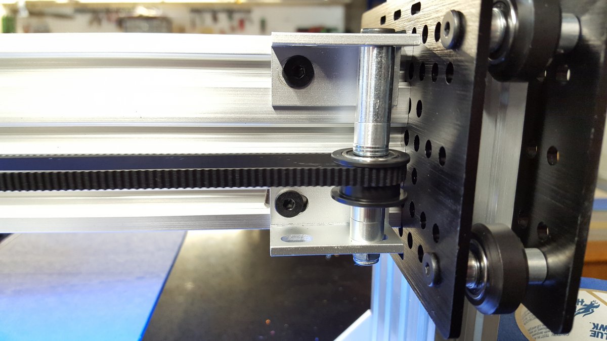

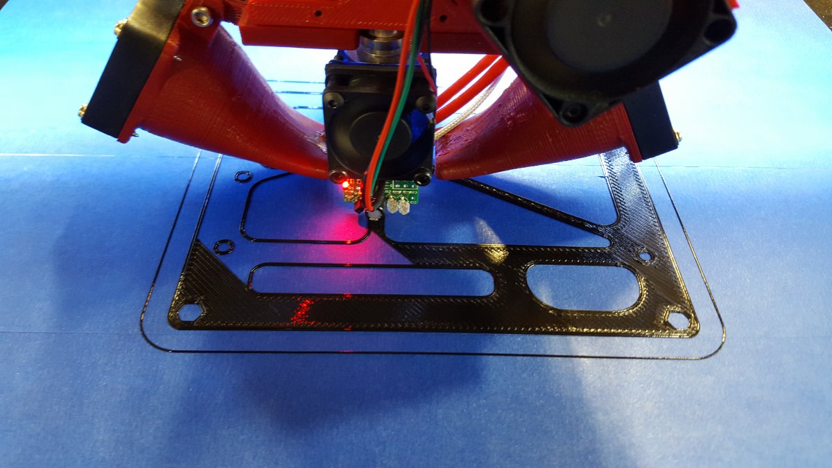

    Here are some pictures of the print quality for those wondering what this design is capable of. I had to twist the drive belts at the idler end of both the X and Y axes. The machine is so ridged, I was actually getting some "ghosting" from the belt teeth running on the smooth idlers. I ran a z wobble test to see what it would do all the way up to the 300 mm mark. Looks real good. I have a 400mm silicon heater on order, so for now Im just printing on blue tape.
    20160123_160543.jpg 20160122_142833.jpg 20160123_171356.jpg 20160123_171837.jpg 20160123_171349.jpg 20160123_171518.jpg

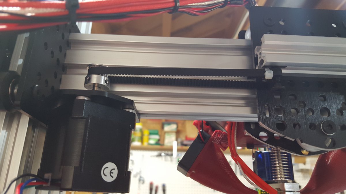

    The x-axis is still belt driven. Haven't gone back to a lead screw driven X/Y since the first printer I built. Reasons being:
    • Arduino MEGAs aren't fast enough to keep up with 1/16 or 1/32 micro stepping going over 80mm/sec with 4 start lead screw. Too many steps, to process. It actually freezes the arduino occasionally while printing. That's not necessarily a print-stopper, but annoying for sure.
    • Because of above, micro stepping has to be reduced to 1/8 on at least one axis making it super loud.
    • Anti-backlash nuts weren't available from OpenBuilds until recently and there aren't many other affordable sources.
    • Lead screw isn't really necessary if your belts are tight. No noticeable backlash in ours.
    ****Other updates*****

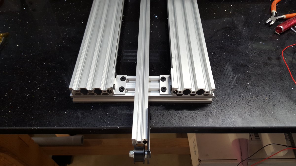

    I updated the Voxel OX Dropbox link for STLs and STEP files to include a better x-idler.
    Dropbox - Voxel Ox 3D Printable Parts
    It uses the same flanged bearings as before. Credit #thehans for taking the initiative. Also made a modification for fitting to c-beam. Probably useful for other builds too.

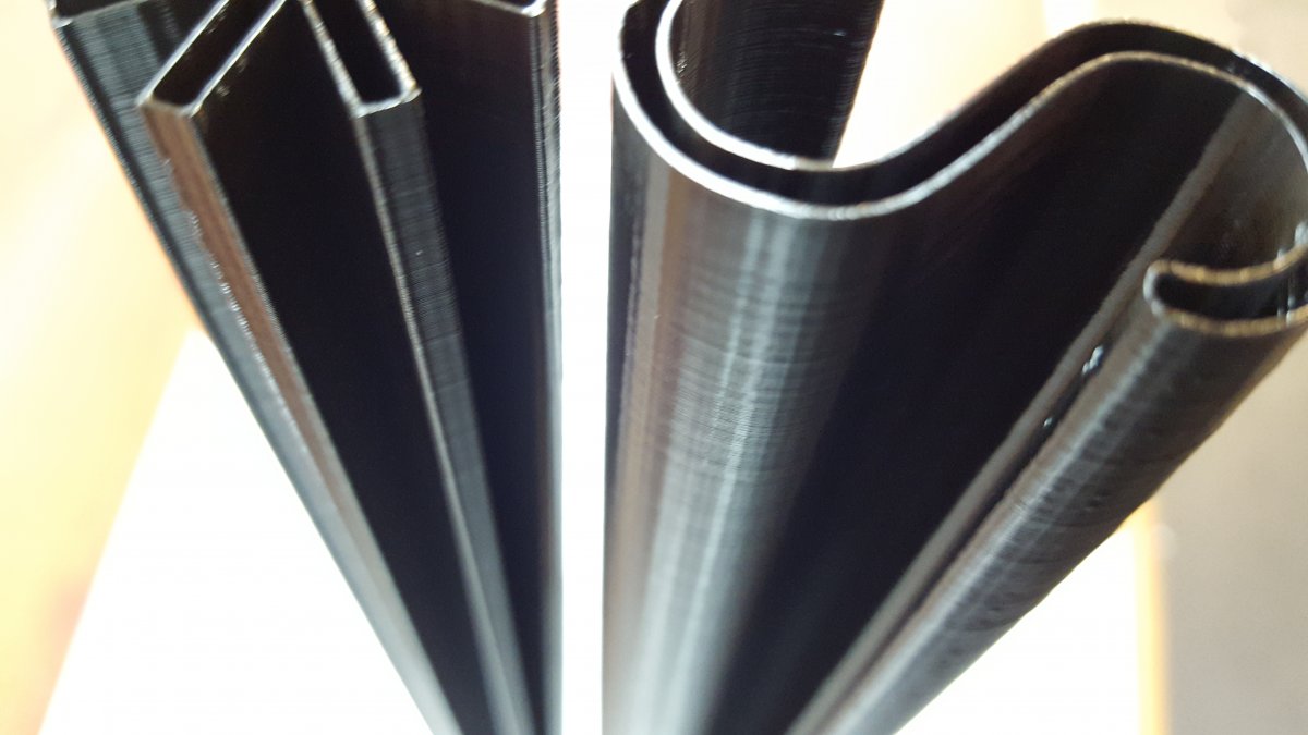

    50 micron (.05mm) is definitely dooable with this printer. I've printed objects at that layer height just fine. The main issue you'll run into at that layer height is going to be less printer limited and more slicer FFF/FDM process limiting. With lower than .1mm, you're likely to run into bed adhesion issues. First layers should be increased up in height and thickness to compensate. You will certainly need more top and bottom layers and more dense infill otherwise those thin print lines will collapse into the model. In general lower layer height will require more material to print nicely. Of course, that does depend on the model somewhat.

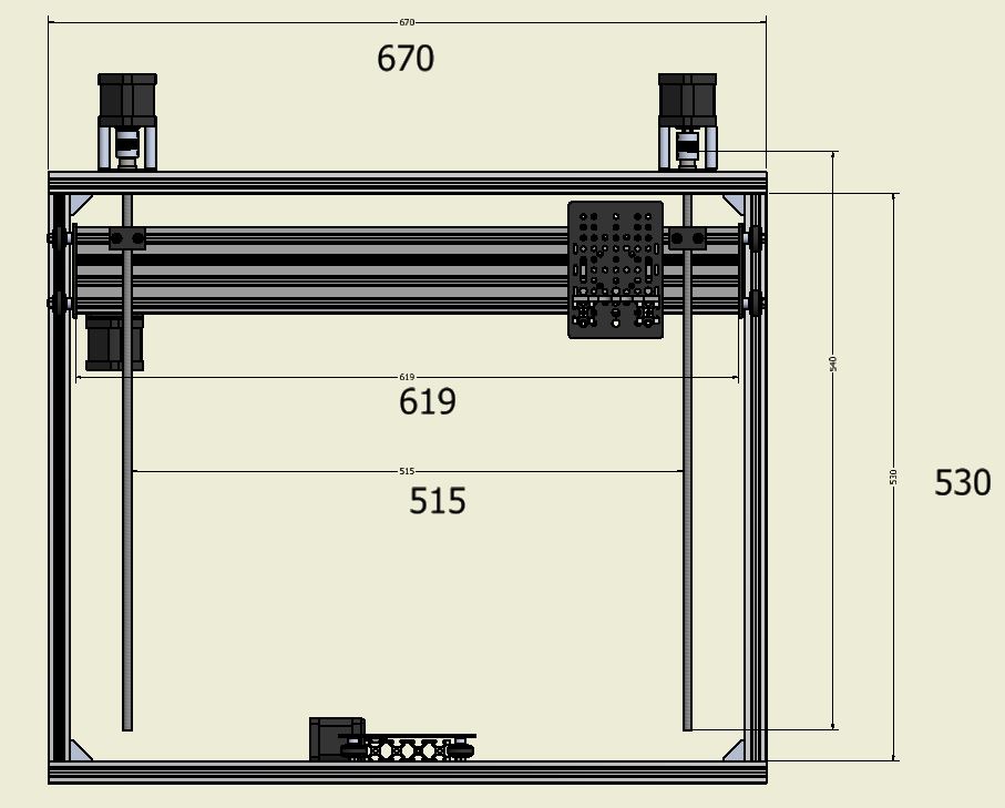

    Im working on a remixed version of this great design. mainly changing to one Z stepper and moving acme screws behind the gantry to maximize X travel
