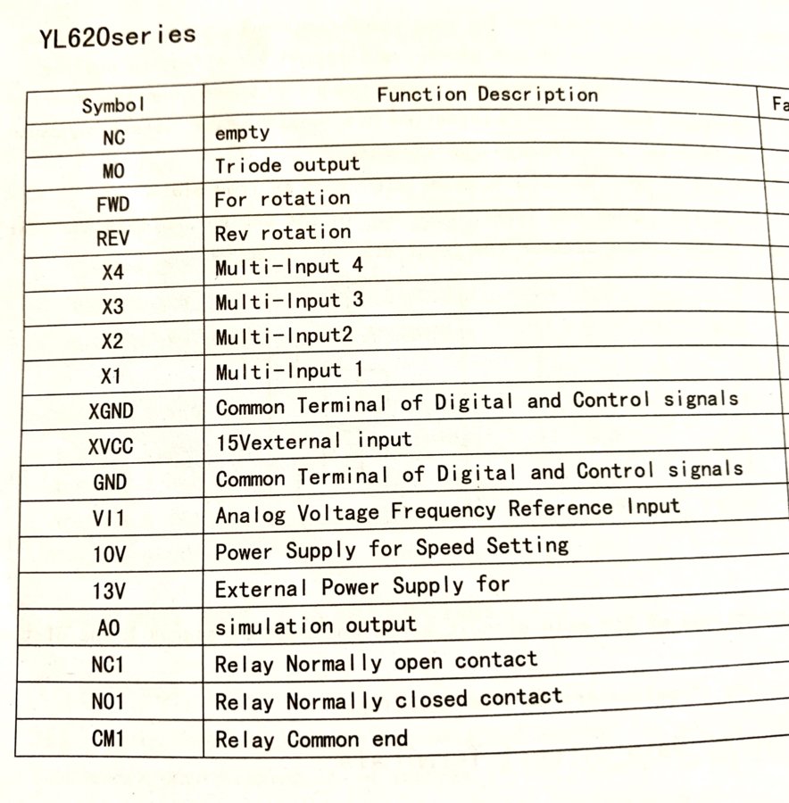

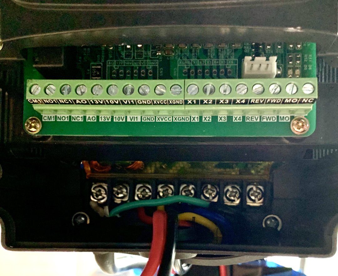

    I am attempting the use the same method but my VFD looks a bit different and does not have the same labeled terminals.
    I have a FWD terminal but do not have DCM, ACM, VI terminals on my VFD.
    I do have VI1 which is - Analog Voltage Frequency Reference Input.
    So,
    Should my Jumper wire go from FWD - XGND and then I will use VI1 and GND to the Black Box?
    Also, you can see I wired the spindle with 14ga AWG individual wires, but they are not not shielded. I did open up the spindle and ground the terminal to the inside spindle chassis.
    Is this wire going to cause problems or should I be using a 4 core 14ga shielded cable for the spindle power?

    BlackBox outputs a 0-10v voltage proportional to the S-value in GCODE, scaled between the values of $30 and $31.
    On the VFD side, its harder for us to comment, as there are so many different models and configs. The section of manual above doesnt have any voltage ratings etc either. Check the manual more in depth if they have extra information, or perhaps ask the seller?
    VFDs spit out a lot of nasty EMI, so shielded signal wires, and a lot of ferrite cores may be needed to tame it
