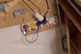

  13. Gary Caruso
    May 19, 2016
    1,186
    531
    Is everything connected to the same power strip I see in the video? you can get filtered power strip, and separate the vfd from the other things.
    Ground loops are harder to make than the internet will make you believe, if everything is connected to the one earth ground of your household wiring then everything is the same "ground".
    Hopefully your house is wired correctly and has no problems.
    Gary
    Bober likes this.
  14. Bober
    Bober New
    Oct 30, 2022
    21
    jest w tym samym pasku vfd
    a u mnie nie ma uziemienia ale mam osobny metrowy przewód wbity w ziemię do cnc i wszystko jest podłączone
  15. Gary Caruso
    May 19, 2016
    1,186
    531
    "it is in the same vfd belt and I have no grounding but I have a separate one-meter cable stuck in the ground to the cnc and everything is connected"
    Need to have the vfd power off the power strip, and if using a different ground rod than your electrical system then there is a chance for a ground loop.
    Gary
    Bober likes this.

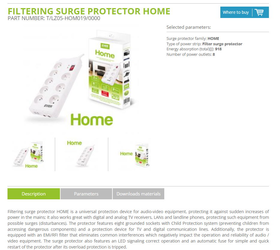

  18. Bober
    Bober New
    Oct 30, 2022
    21
    I bought such an emi filter, maybe it will help connect it to the vfd

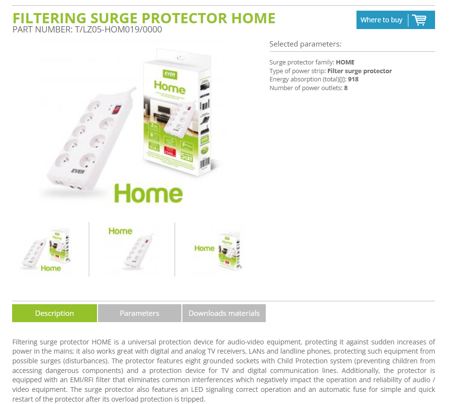

  19. Bober
    Bober New
    Oct 30, 2022
    21
    Emisja filtra
