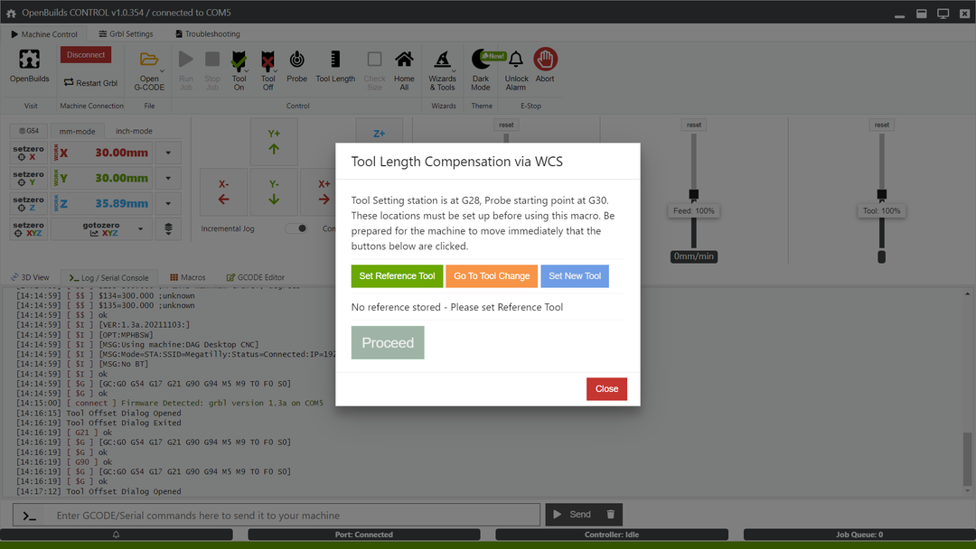

    Any plans to add a bit setter to a known position?
    My other Cnc it finishes the current job and moves up and middle to the front of the machine for you to change to the next tool, then moves to the bit setter height lowers down to measure the new tool height and moves to the next tool path for that tool with perfect Z zero
