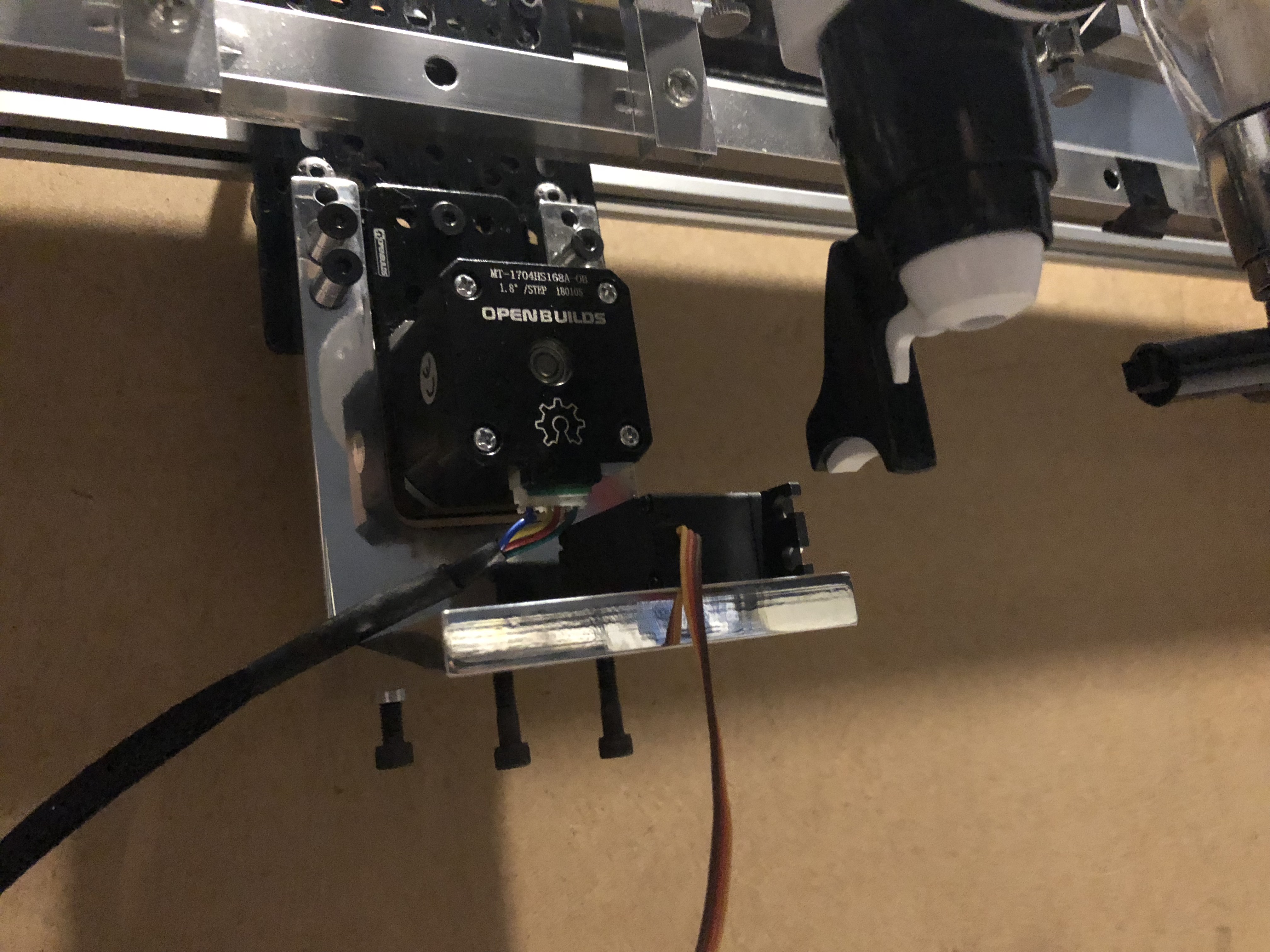

    V-Slot™ Belt & Pinion Example Build
    To be more specific, it is set up like this:
    https://openbuilds.com/attachments/belt-and-pinion_example_1-jpg.136/
    I am NOT building a CNC machine... its for a personal project that needed some linear rails and a stepper to move a gantry...etc..
    My question is.. how much weight can the v-wheels/gantry hold?
    I need to connect some components to the 'v-slot gantry plate'
    V-Slot® Gantry Plate - Universal
    that will hang down....
    I milled my current test parts from some .40 thick aluminum flat stock... but got curious as to the weight limits here? (as I still need to make more parts to complete it)

    This is not for a CNC machine.. (so I'm not sure what deflection you are referring to)
    I would imaging these v-wheels and bearing shave some sort of specs on them?
    If the gantry and wheel system are set up like the rack and pinion example linked to above... (ie: the gantry plate (top) is facing you (vertical))..
    and I was connecting something to that gantry plate..that hangs down.... there is no recommended max 'weight' that ruins the wheels? bearings?
    I dont know if any of the cnc systems people have created here have their rotors mounted on a plate in that direction/orientation... but how much does the average router weigh?
    This is a permanent fixture.. (and again NOT a CNC machine, that will have any kind of backlash or push-back/resistance from a material it is cutting)
    I have machined a bracket (like a U shape) that connects to the gantry plate holes, and goes 'around' the stepper motor, hanging down.. with a 'ledge' on it..
    example: (big image) https://www.dmstudios.net/misc/barbot_bracket/IMG_0676.JPG
    but I still need to add more that will hang below what is displayed in the image... so weight concerns popped up.
    So I guess in this case.. 'axle snapping' -is- the question.. (or more so I was thinking wheel deformation? or liner rail wear and tear? or bearing issues?)

  7. Giarc
    2,915
    1,619
    My y axis gantry - with the spindle and everything - probably weighs about 20 to 25 pounds and rides on 8 wheels. 4 on each side. I don't know if this helps you.

    40
    This does help! Thank you.
    I would imagine the 8 wheels help distribute the weight better, but this is a start!.. and gives me a ballpark on what is acceptable (or normal use) instead of being 'overkill'.
