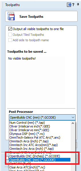

    Being new to openbuilds with my lead cnc, I am thinking of trying the v carve pro cad design software free trial version for now, will it be compatible with the blackbox ? So much to learn
  2. Giarc
    2,915
    1,619
    Yes. There is a grbl post processor for Vcarve. The BlackBox flavor of Gcode is grbl.
  3. Peter Van Der Walt
    13,992
    4,107
    And newer versions even have an OpenBuilds CNC Post (slightly modified from the Grbl posts - you can technically use either, the OpenBuilds one just has extra timeout for spindle spin-up, and gets rid of GCODES that Grbl does not support (M6 etc)
    Giarc likes this.

  5. PeterPasse
    Jun 11, 2019
    I have an older version of V Carve Pro 7.5. There are no p/p for Grbl. How can I get the Openbuilds Grbl to load into my V Carve? I just purchase an OpenBuilds Lead 1515 (awaiting shipping) and would like to use the V Carve that I have to design and send directly to the black box controller. Thanks Pete
  6. PeterPasse
    Jun 11, 2019
    How can I get a download of the OpenBuilds P/p for V Carve Pro 7.5 ? Thanks Pete
  7. Alex Chambers
    2,694
    1,325
    Here;
    docs:software:vectric [OpenBuilds Documentation]
    Edit - just read your post properly the link (you have probably already found that out) is for a later edition of Vectric software. Don't know whether thaty works or not. Have you got a grbl (mm) (*.g-code) pp for your version?

  10. PeterPasse
    Jun 11, 2019
    Yes, there was a download for older versions. I downloaded it and copied it to My P/P in V Carve. I shut down V carve and started it again and got an error window that said: Config File, Unknown statement found in file on line 46 of file, C:\Documents and Settings\ll Users, Windows\Application Data\ Vectric\VCarve Pro\V7,5\My_PostP\OpenBuilds_inch.pp POST_BASE = "gRBL_INCH.PP"
  11. Alex Chambers
    2,694
    1,325
    Sorry - can't help much with that V7. 5 is before my time. Hopefully someone else will join in this thread. I never put a pp in "my pp" because it becomes the only one available - I always put them in the folder with the rest of the post processors.

  16. PeterPasse
    Jun 11, 2019
    I found the code in the download that I used. It has a POST_NAME = "OpenbBuilds GRBL (Inches) (*.GCODE) and a POST_BASE = "Grbl_inch.pp" FILE_EXTENTION = "GCODE" UNITS = "INCHES" It is the POST_BASE THAT V Carve does not like as an unknown statement. What would it like for a POST_BASE do you think?
  17. sharmstr
    2,035
    1,431
    If no one can help you here, post a message or search the vectric forums for and older grbl post processor. Even if you find one, there's no guarantee that it will work. In looking at the current post (which you can open with a text editor), it doesn't like the line "POST_BASE = "Grbl_inch.pp"". That information will give you so detail to ask over in their forums.
    Edit: we replied at the same time. Here: What does the Post_Base command do
    That tells me that it also needs the file in the main posts folder. But since there is no grbl base post it errors. Perhaps take it out? Again, you might be better off over at the Vectric forums.

  20. PeterPasse
    Jun 11, 2019
    Thanks, I loaded it and no error windows. Made changes that were also in thread. Have to wait for my machine to arrive and will try it. Saved toolpaths from existing files and no errors either. Thanks Pete
