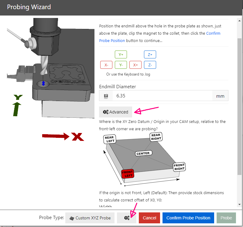

    14,701
    4,249
    You can still use it with CONTROL
    PROBE wizard > Probe Type > Custom > click the Gear icon > set your dimensions as offsets.
    No macro needed

  6. David the swarfer
    3,393
    1,892
    check under advanced (top arrow in image below) for which corner you selected
    the bottom arrow points at the place where you set custom probe block size

  8. David the swarfer
    3,393
    1,892
    you put in the stock dimension because we always probe front left corner and then set the offset from there using the stock dimensions.
    if you are probing and using the front left corner, then the dimensions are not needed
