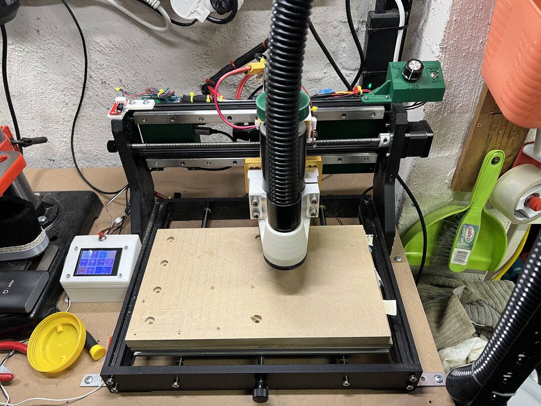

    The 500w spindle was good to learn on, but the balance wasn’t great and the Chinese power supply was a death trap which eventually blew up.

    Honestly, if I hadn’t been able to buy my almost new Makita for $160 aud, I’d have bought the RoutER11.

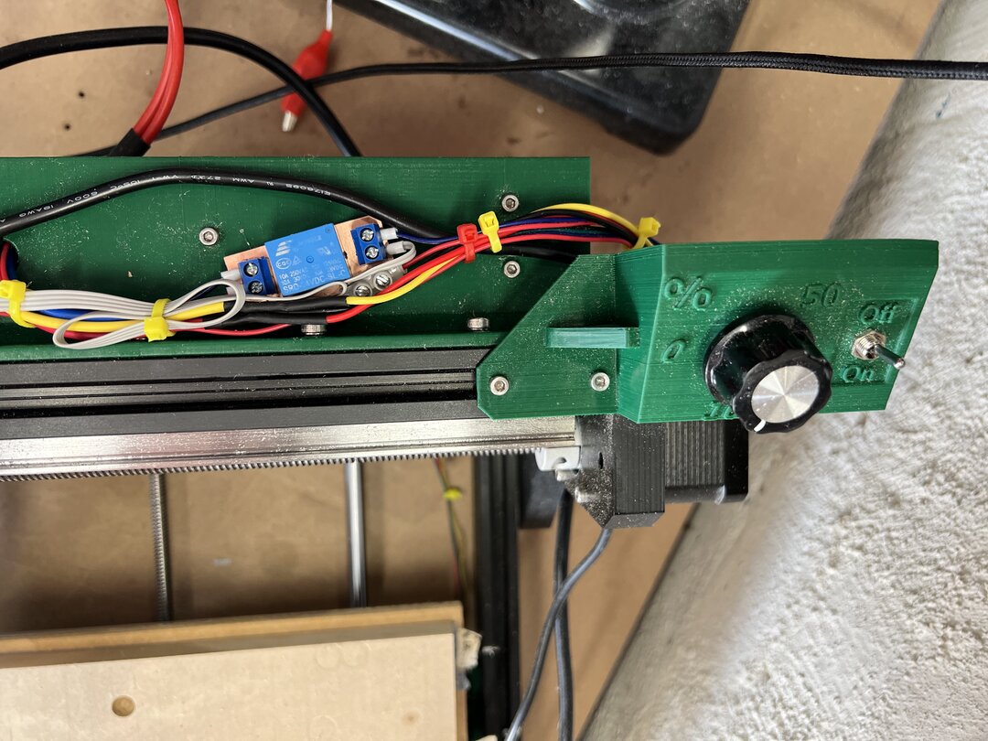

    I made some great progress on my Makita speed controller + DLC32 project today
    I figured out how PWM speed control needs to be configured for the GRBL_SPD board in FluidNC and it works really well now.
    I just need to put my CNC machine back together!

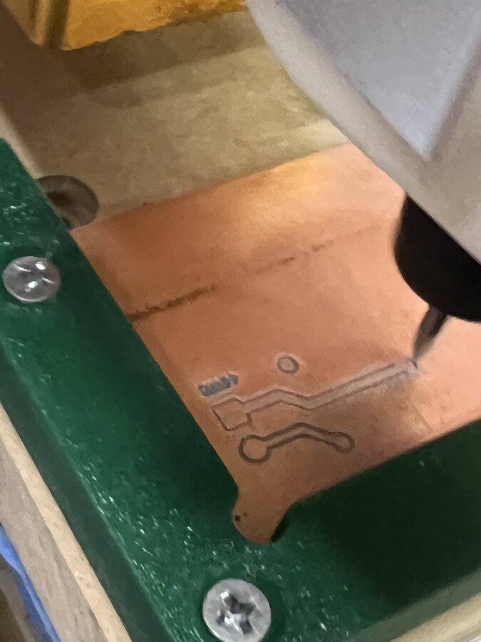

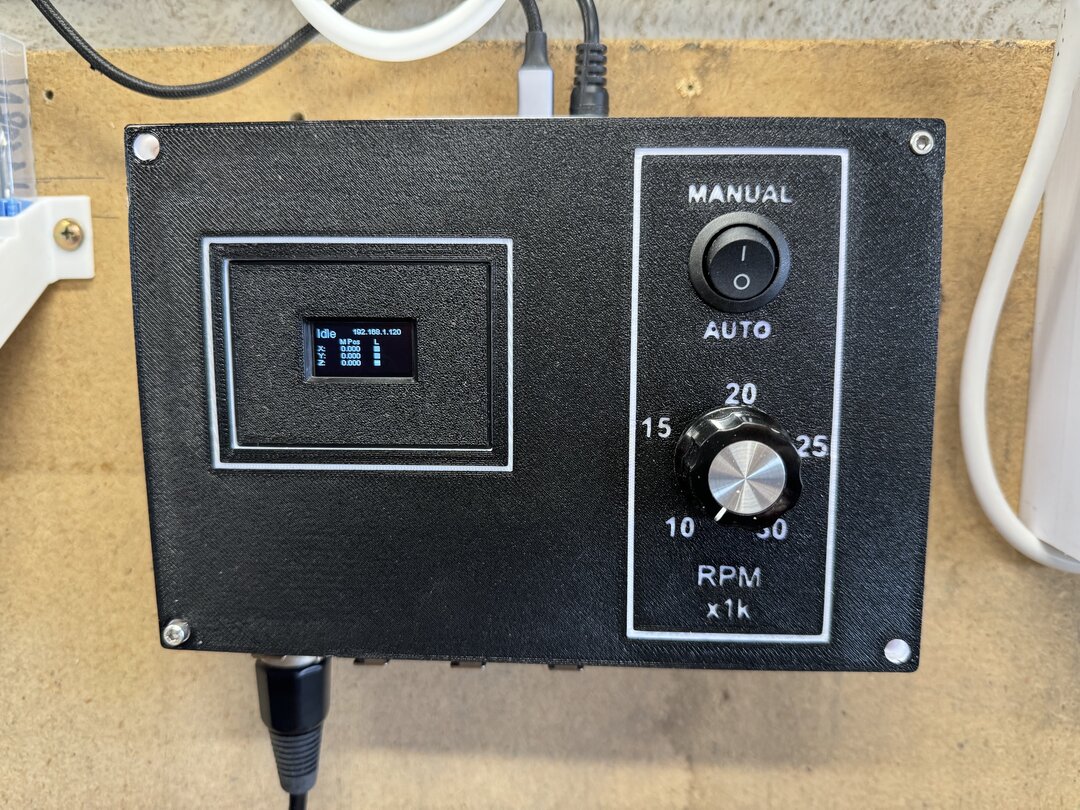

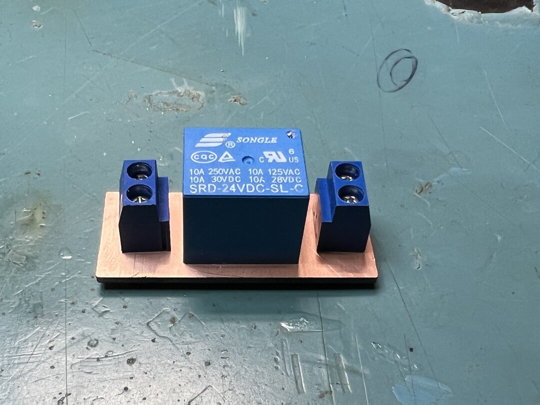

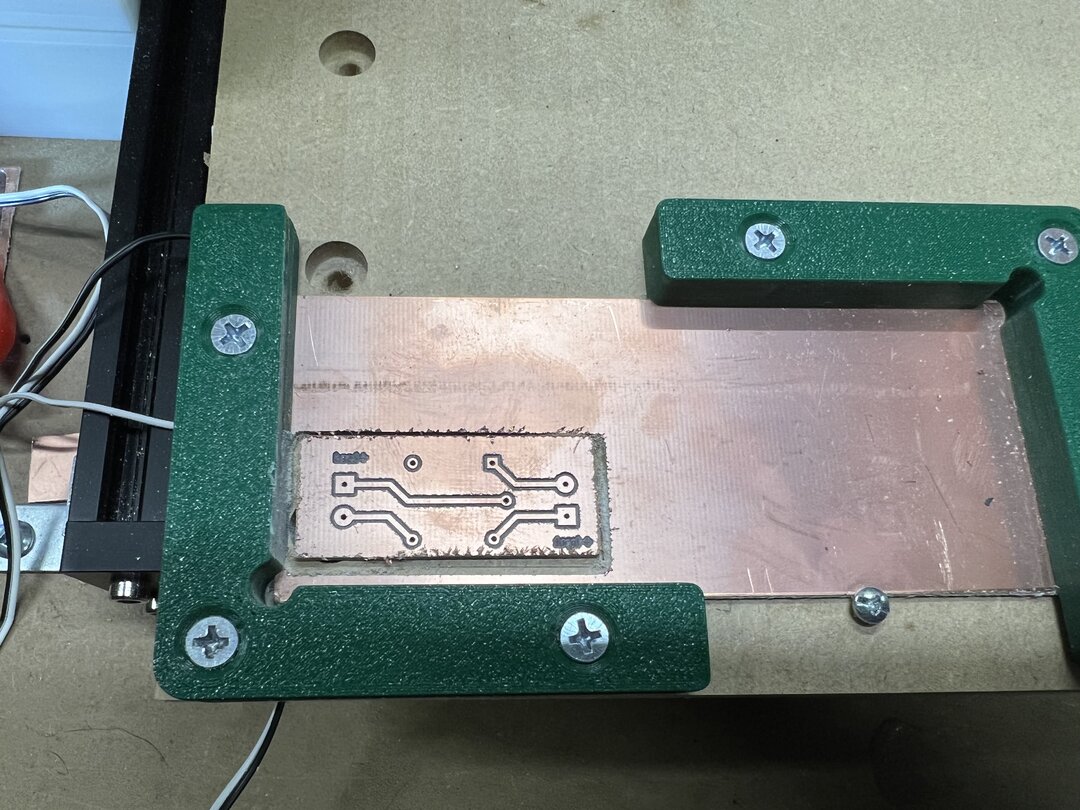

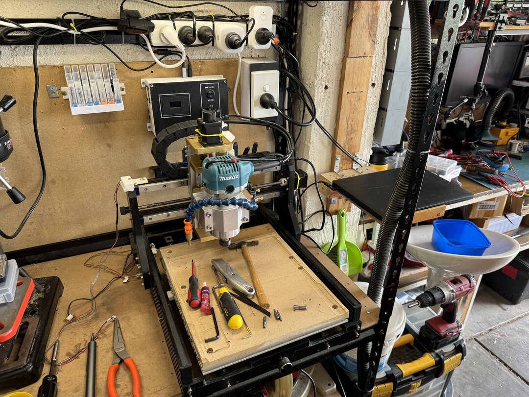

    I made some good progress putting my CNC machine back together - but I forgot to buy some good quality stepper motor cable. Doh! I'll have to go buy some tomorrow.
    I also made an insert to replace the TS24 LCD with a FluidNC compatible .96" OLED Display. It's not as functional as the old touch screen, but it does the job.

  18. dJOS_500
    dJOS_500 Journeyman
    Jul 16, 2022
    271
    120
    Hehe, thank you.
    PS, I've updated my CNC controller cases with the optional insert:
    Printables

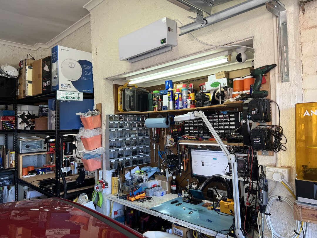

    Cheers, I'd love a bigger space - but the wife would not appreciate me taking over our 2 car garage with my hobbies. :(
    Nice, I'm just an IT nerd who designs and makes things to stay sane. :banghead:
