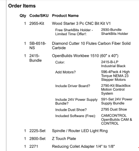

    Hi Peter, It's me again I would like to do the order of the parts list for upgrading my machine to lead screw. you help me with this in past maybe you can help me understand which parts I need to order, I want to do the order now in the Black Friday event.
    also attaching my machine technical info:
    thanks Yanai.
  12. Peter Van Der Walt
    13,753
    4,070
    Check in with the store via Support
