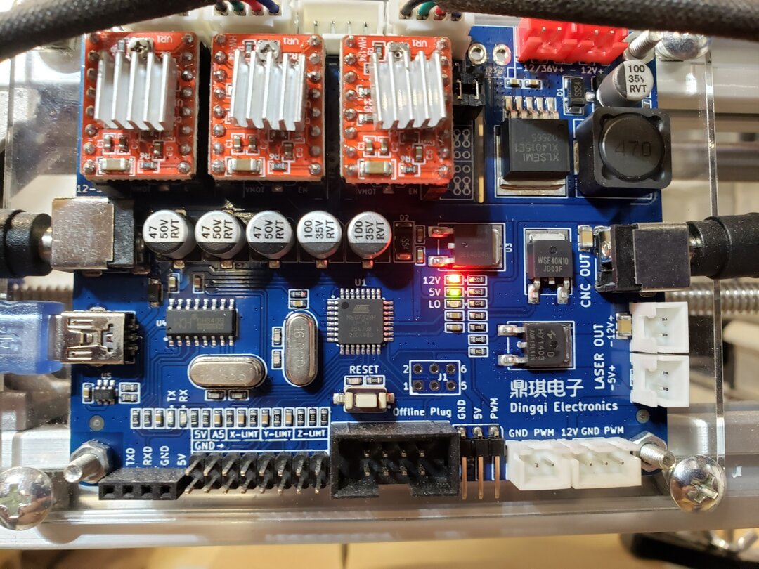

    I just purchased a 3018 CNC machine from Banggood. It has GRBL 0.9J loaded on it. Is there any real advantage to trying to update it to GRBL 1.1h if I don't plan on adding a laser? This is the board I have...
    If I DO want to upgrade it, any ideas on whether XLoader would work?

    That's the board I have on my machine, and I want to upgrade mine. I see a lot of talk about Arduino, is there an Arduino embedded on the control board do you know ?

    If you see an "atmega328" chip onboard thats the "arduino" part
    If you don't mind the risk of possibly bricking it (can be recovered if you buy a $5 USBtinyISP) if something goes wrong, you can try flashing Grbl 1.1 using OpenBuildsCONTROL > Wizards and tools > Firmware flashing tool > BlackBox 4X (also AT328P based)

    BakaNeko's photo is the same as my board...
    Well I went for it ....
    Now the console has cycled round [COM1] [COM17] [COM6] a few times.
    So what do I do now ?

    Actually no harm done - still working .... phew !!

    Won't be easy to update that then
    But - consider a BlackBox. Grbl 1.1 is getting old too - the newer generation BlackBox X32 runs on grblHAL, 32 bit CPU, wifi, all kinds of nice modern features: See docs:blackbox-x32:start [OpenBuilds Documentation]
