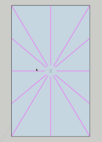

  12. David the swarfer
    3,393
    1,892
    I just cooked up a little test in Sketchup, a rectangle with radial lines like this
    the radials are purple because I have set them to be 'fold tool cuts'.
    Material is 6mm, fold cuts are 50% deep, so cuts are 3mm deep.
    Generating Gcode from that (with SketchUcam plugin) gets me file grooves.nc , attached. That will cut constant depth grooves, 3mm deep.
    I then edit the file to make the lines slope, I had to find the ends nearest the center (center is the 0,0,0 point) and make sure
    that end of the line is at Z0 and the other, outer end is at Z-3
    That gives me file grooves2.nc, attached.
    Size and shape of the cutter doesn't really matter to this Gcode, adjust feedrates to suite, material is 150x250mm or smaller.
    Go ahead and cut a piece of insulation foam with this and make sure you understand what I have done and why, and then you are ready to do your own.
    (well, try, but test on foam, mistakes will happen)
