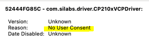

    The driver is still listed as Disabled in the System Info for some reason

  18. Peter Van Der Walt
    14,868
    4,283
    Did you try No User Consent - Apple Community

    I reviewed all of the links that you posted and confirmed that my machine is configured like they suggested. I even disabled the System Integrity Protection (SIP) as per one of the articles.
    dov@Dovs-MacBook-Air ~ % csrutil status
    System Integrity Protection status: disabled.
    The difference between my situation and the other guy that posted may be that my laptop never had an earlier version of Mac OS on it - it was always Sonoma which is after the changes that were made for High Sierra. In the Kernel doc you referenced - it mentioned that once you have something approved it will be grandfathered in for future updates.
    When I run the Windows VM on my Macbook, it is able to connect to the BlackBox x32 thru the same cable that fails under Mac OS. Somehow Windows knows how to handle the hardware better than the Mac does.
    I configured the Wifi on the BlackBox while I was connected thru the virtual machine and it worked for awhile until I restarted the blackbox but now I cant see it when I scan for the network. When I check back thru the VM, I can see the GRBL settings for my Wifi but it doesn't look like it connected properly.
    Bottom line I am still stuck where I was on Sunday
  22. Peter Van Der Walt
    14,868
    4,283
    Thanks for confirming. Speak to your Mac guy, its definately a permissions issue per that screenshot you provided, so just not sure how to provide permission (not a Mac user) - they always look cool, but overly complicated in an effort to appear user friendly (but still unix under the covers)

    Does this still show the No User Consent thing?
  30. Dov Rosenberg
    Jan 21, 2024
    50
    Yes it does. I think that information is stored in a protected database as part of the configuration. Deleting the driver did not clean that up
