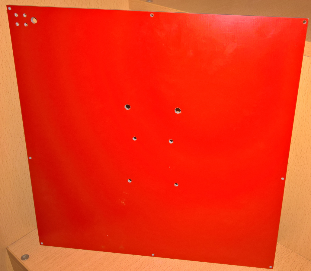

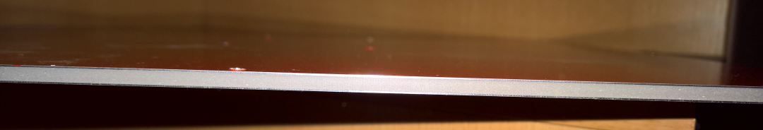

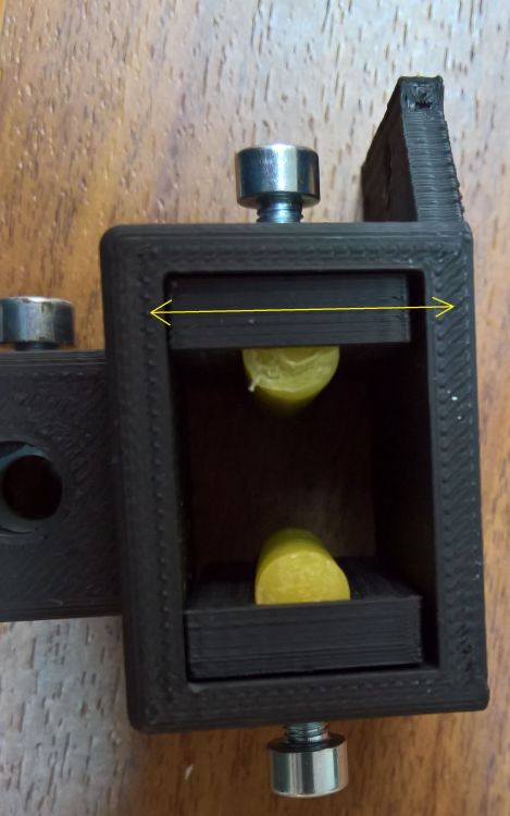

    Keith, thank you! Printed and assembled new Z screw mounts. But have a "play" between this parts:
    They rotating a little. Do i printed them wrong? I can fix this by drilling extra holes for another setscrews to fix them rock solid, but i can print them with little scaling to fit them tight.
    Made my build plate from Aluminium Composite Panel like this. costs me only 7,5$
    Here are some photos:
    Maybe will be useful as alternative to aluminium plate.

    I had this issue too when I printed them. Tried the scaling, but that also increases the cutout that holds the nylon rod and had the same wobble. Ended up using OpenSCAD to expand out the edges, keeping the same taper but increasing the width.
    Code:
    translate([-0.0188, -0.02365, 0]) import("Bushing - kit.stl", convexity=10);
    translate([0, -0.51, 0]) intersection()
        cube([45, 3, 10]);
    translate([0, 0.51, 0]) intersection()
        translate([0, 18, 0]) cube([45, 3, 10]);
    I used S3D to separate the part from the STL file. I'm attaching it for completeness and so you will have the same part that fits the offsets I used.

    Print the glide body (with cavity) and the bushing inserts on the same print, with the width of the cavity and width of the insert being both set by the Y axis travel. That way, regardless of how close your printer is calibrated, the cavity and insert get the same variation. Guaranteed, if you print the cavity width set by Y travel and insert width by X travel, you will get a mis-match.
    Have you had a chance to mount the aluminum sandwich build plate? Is the aluminum film strong enough to take the pressure when setting the eccentric spacers and how well do the holes it hold up to usage. Also, what saw blade did you use for trimming the size to get a clean edge? I'm truly amazed that no one offers a 216x216 blank build plate and am always on the lookout for a plate where I'm not paying double for some idiotic 20 holes punched in it. The only thing I can find are 2mm thick which are to thin for the eccentric

    Hello Elmo. I added +0,4mm to each side and get a very tight fit, Thank You.
    Hello Keith. The thing why i wanted to build TrueUP is my "never calibrated enough Wanhao i3" I want to build TrueUP, print all parts again and reassemble it.
    I assembled it to try how it will work, and it worked perfectly, no damage to holes from eccentric spacers (and i tight them more than enough), but nylon nuts are pressing aluminium a little, but fender washer will fix it. Also it 4mm (+1mm thickness) so i need longer screws for wheels and to mount heat bed. Overhanged 2/3 from the desc and put 4,5kg to the edge. The edge goes 3,5-4mm down.
    About how the plate was made. It's CNC milled on portal CNC mill. The Agencies of outdoor advertising often have both, portal CNC mill and aluminium composite (i used their CNC mill to made my plate). 7,5$ is the price that includes milling.
    Eccentrics tightened to max
    Holes after
    disassembling
    Scratches are from needle file.
