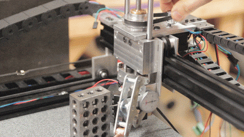

    Parallel Y: lock one side up with your cross-braces and make sure the V-wheels are nice and tight. On the other side, the end brackets are snugged but not tightened, but one end tighter than the other, so you can tap them around but they don't otherwise move. Run an indicator from the gantry against the looser y-rail, tapping the rail in as you drive back and forth, just like tramming in a vise. When the needle stays still, lock in the tighter end and maybe an 1/8 turn on the looser end, and then do a couple more runs. Last couple taps if necessary, then lock in that last corner. You now have two parallel rails, connected by two unknown-angle cross-beams. But the connectors don't need to be perfectly square, technically.
    Perpendicular X: perpendicularity in terms of racking (ie. rotation in C, or about Z) is a function of the wheels and the connection method to the gantry uprights. If the connection is perfectly square, and the wheels are nice and tight, the lowest-energy state of the system is perpendicularity; it'll settle there naturally. Once you get the belts and motors hooked up, that gets a little more complex; you really need to sweep a square based off the master y-axis rail, though cutting x and y lines and measuring the squareness is probably sufficient for most purposes. The one that can need doing depending on how your uprights are configured is also the X axis tilt in B. Sweeping a flat surface supported by, or otherwise coplanar with, your base rails and adjusting the height of one side of the X rail works for that just fine. Tilt in A, ie. rotation about its own axis, has to be addressed when tramming Z.
    Perpendicular Z: Simply sweeping a 1-2-3 block is how I did this:
    None of this seems very helpful in text format, but hopefully it got some of the point across. I have all the video but haven't done anything with it yet, maybe I should get on that.

    Please watch video below, around 5min 10 seconds onward has really good insight
