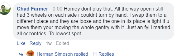

    I have a workbee 1510 had since Thursday I have the y axis that is in a bind I took out the tight wheels and changed them with other ones. same problem, double and triple checked to make sure all spcers are there and made sure right spacers the other side I have checked the spacers are right all escentrics are at the lowest if I tighten up any the wheels get way to tight and don't want to turn. the left side all 3 of the bottom inside are too tight …. im at a loss anyone im getting aggravated at it I tried to cut a circle my wood cnc does a better job. I loosened up the bolts to see if they would help no dice

  20. Giarc
    2,996
    1,673
    I believe he said on Facebook that he moved the wheels to different spots on the plate and then they spun freely. The wheels he moved to the trouble area then were locked up. It is tough to keep track since stuff is posted in multiple locations and various forums such as here and Facebook. It could possibly be the plate.
  21. Dmhaes
    Dmhaes New
    Jan 3, 2019
    40
    20
    I’m no pro, but I think taking measurements of both the rails, and the spacing between the holes in the plates would probably yield an answer. I remember him saying the problem didn’t move with the wheels when they were swapped around, it stayed in the same place.It sounds to me like something is off with either a plate, a rail, or a combination of the two. Hard to troubleshoot over the web though.
