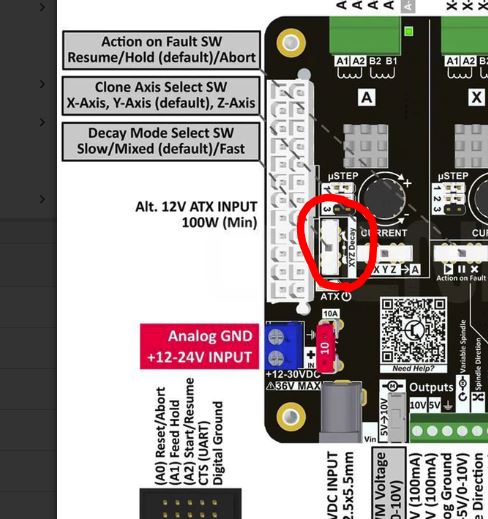

    Everything was running smooth as could be when I noticed an odd noise after a cut job finished. It sounded like a full hard drive searching for files. I don't have a hard drive in my shop. The noise was coming from my steppers! I don't have anything electrical running, or anything new plugged in that I didn't already have there. I turned off the power supply for a while and switched it back on and it was fine for a minute and it went back to making the noise. I jogged the machine around, and it sounds like it's going to fall apart. It smooths out on occasion, but seems to be getting worse with time. I checked my wiring connections (all seems ok). Checked the voltage from the power supply (24v steady) Turned the voltage down and up, and it just made the noise decrease or increase. I tried adjusting the amperage (no change). Not sure whether the control board is screwed or what is going on. I also disconnected the usb cable with no difference. Z axis doesn't seem to be as bad in the video, but it is affected the same way when jogging it. The steppernoise file is the noise it is making while just sitting there powered on.

  8. Jack D
    Jack D Well-Known
    Staff Member Builder
    Aug 22, 2018
    27
    178
    My mistake. Looks to me I am already running 1/8 step unless I'm reading it wrong. IMG_20190414_134322609.jpg IMG_20190414_134435511.jpg

  10. Jack D
    Jack D Well-Known
    Aug 22, 2018
    27
    178
    Yeah I can try that. I haven't ran any long jobs since this happened. And nope, no metal cutting has ever been done on it, so no chance of a short from shavings
  11. Jack D
    Jack D Well-Known
    Aug 22, 2018
    27
    178
    Okay... Slow decay recreated the problem instantly. Fast decay runs normal, as does mixed. Mixed (default) is where it has been, and where is was acting up on extended run. I'll try leaving it on fast decay on my next long cut, unless you think it might indicate something else?

    Well I took the steppers off the machine, and switched into slow decay mode. They feel rough running in my hands. They sound rough while holding them. Checked all the wire connections by pulling on each wire, then took the wires out of the connectors to make sure they were making contact on the wires and not just the insulation. Re tightened the connections. Pulled on each wire again. Ran the motors again. Still run rough. Switched back to mixed decay mode. Motors run and sound smooth in my hands. Fast decay mode, I hear a slight hissing sound, or something like that, coming from the motors, but they run and sound smooth. Mount the motors back on the machine, and it is as it was before. Rough sounding in slow decay mode, smooth and normal sounding in mixed and fast decay mode. I will need to run a long cutting job to see if it acts back up, but I suspect that it will.

    The hissing sound in fast decay mode is normal. I leave mine in fast mode.
    I'm an electrical design engineer. I've looked at the spec sheet for the driver chips on that board. The smoothest and most linear operation will be in fast mode. Slow mode is an attempt to conserve power. Mixed mode tries to automatically switch between the two based on current conditions. However changing dynamically between slow and fast can cause nonlinear microstepping. Fast mode avoids this, but you have to tolerate the electrical noise you hear. Smooth operation is more important to me.

    Just posting to let you guys know that since switching the controller to fast mode, I have not experienced the issue again. That seems to have solved the problem as far as I can tell. I have ran a couple 10 hour jobs, and a handful of 2+ hour jobs, and it remains running smooth. Thank you all for your input, and help. :thumbsup::)
