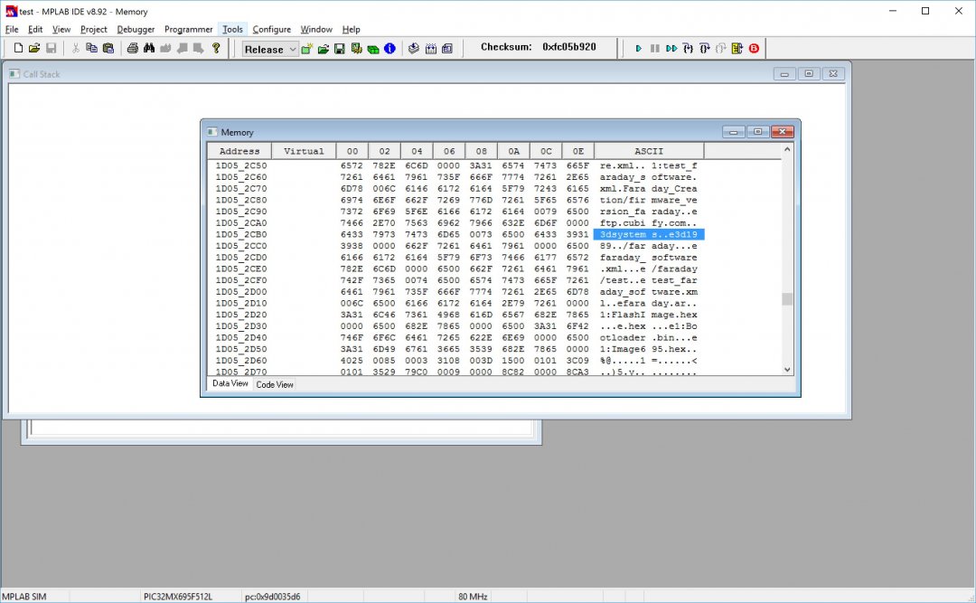

  20. eychei
    eychei Veteran
    Dec 26, 2016
    144

    Hi everyone,
    I do want to join this thread. There is no conversation going on here. Is this thread dead?
    I did buy a CubePro and want to help out. It seams that the mainboard for Cube3 and Cubepro are the same.
    I am familiar with IDA and can also help out with some reading / writting the firmware onto my board.
    I was active with some Stratasys hacking (googlegroup Stratahackers). See my posts here:
    Using Insight with any Printer and sending it your own
    Howto use Insight with Dimension Models
    I did have to sell my Stratasys printer and got me the Cubepro. Will do what is necessary to get this printer going.

  21. eychei
    eychei Veteran
    Dec 26, 2016
    144
    34
    @Geezer70
    I did load the hex file into MPLAB IDE but the Simulator isnt working for me.
    Can you give a little bit of assistance?
    Starting the Simulator gives me Error :E0108-SIM: Failed simulator operation: java.lang.NullPointerException
    I can attach the hex file if needed.

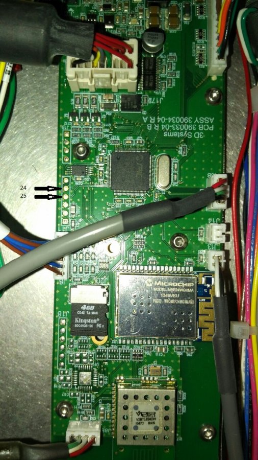

  23. eychei
    eychei Veteran
    Dec 26, 2016
    144
    34
    I have found the ICSP header. Will get a pic32 programmer from ebay.
    Kiza likes this.
  24. Kiza
    Kiza Journeyman
    Dec 1, 2016
    75
    I did find it too :) Waiting for my programmer for arrive so I can try to do some tracing as well. Digging through PIC32 assembly is quite hard for me. Without an access to the live system I'm trying to run the firmware on Qemu with PIC32MX7 support. But it is quite raw, have to write some additional code for it. So far I know that SD Card is on SPI2, chip select is on Port C, pin 3. But no luck having SD card working with it. The reason I want to see the contents of SD Card is to find out if we can disable cartridge checking through configuration files.

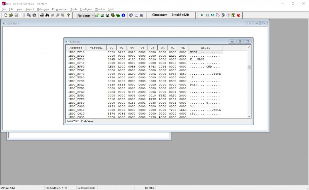

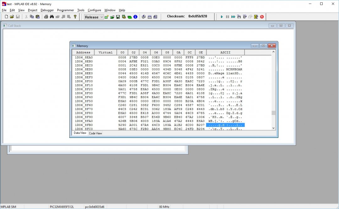

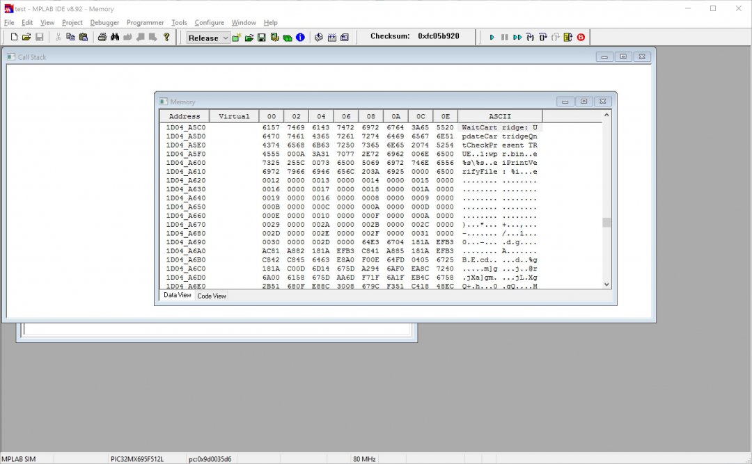

    eychei Veteran
    Dec 26, 2016
    144
    34
    Me again.
    MPLAB X SIM didnt work for me. Used the old IDE MPLAB and could search in the memory for some stuff.
    In addition to what geezer70 posted I did find these things:
    The User 3d and Password print3d doesn't work for Telnet. Should be for ftp. But ftp is disabled.
    The FTP Server ftp.cubify.com is also in the firmware. But the login data doesn't work.
    Did find something else in memory about Cartridge quantity check present True. Maybe this can be useful.

  30. Geezer70
    Geezer70 Journeyman
    Sep 30, 2016
    45
    @eychei, @Kiza
    When attaching the PICKit3 to the ICSP header, MCLR is low this causes the Cube to hard reset and not restart until it is removed
    I did disconnect all hardware and attempt to power the motherboard with PICKit3. However, it can only supply about 80ma. Noit enough to bring up the board. I'm going to attempt connecting via JTAG and muddle around.
    Parsing an .ar file so that only the Intel Hex remains can be Imported, I repete IMPORTED, into MPLAB IDE.
    Create a new project, setup with PIC32MX695F512L. File Import *.hex. Set active project to the current one.
    Set Debugger to MPLAB - SIM. View/CPU Registers, /SFR peripherals, /Memory. The Memory window has all the code disasembled
    Click Data View for data or Code View for Duh, Code. You can save either to a txt file by right clicking on the widow "output to file".
    If you run the Sim you'll get an error because it executes at the beginning of the boot loader which attempts to load the executable
    at 9D00_0200 which is side 0, upper memory and fails because it is non-existing address.
    This will NOT debug the software. But, it allows you to view the Code and Data for disassempled clues.
    In order to actually run code and set break points, etc. you have to have an image loaded on a PIC32 chip and interfaced with a PICKit3.
    You can choose to load it on the Cube or a dev board. Either way the Flash area of the device will be ERASED before loading
    the new Image. That's just the it works. That's the reason you can't dump the Flash from the Cube via a PICKit3 through the ICSP header. I think the Code Protect fuse is set. But I haven't looked into it.
    If anyone knows how to get around this, please let us know.
