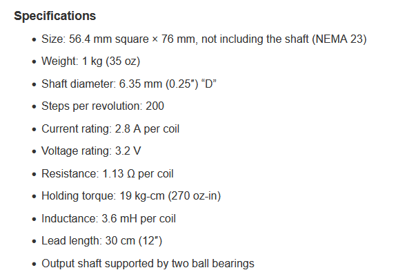

    Is those motor will work with my BbX32?
    Amazon.ca
  23. Peter Van Der Walt
    13,992
    4,107
    They don't have a decent datasheet? But I am going to guess that its not going to be a great match:
    BlackBox likes motors with 3v coils, 1-2mH inductance. In fact, checkout NEMA 23 Stepper Motor - High Torque Series - with carefully configured electrical specs to be a perfect match for BlackBox.
