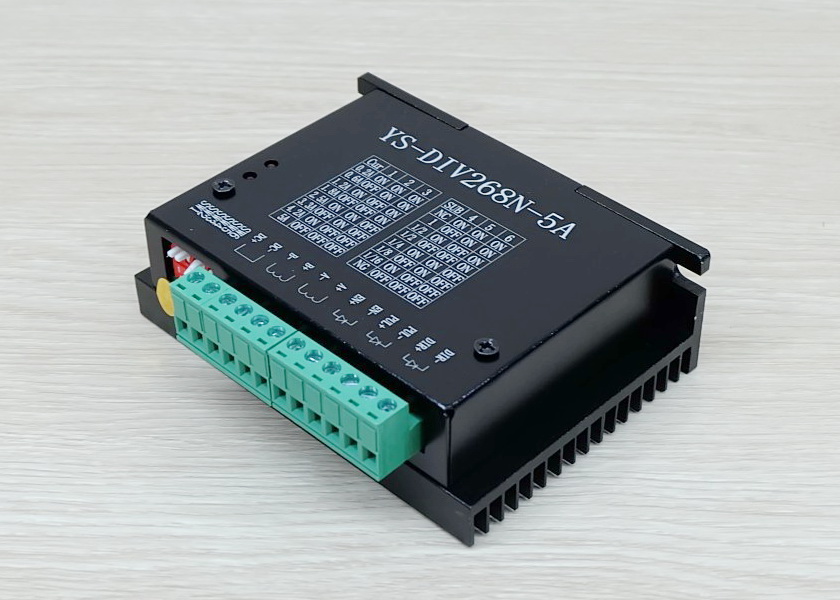

    What stepper drivers did you use? (Some make the motors more noisy than others. IME the ones sold as DIV268 are particularly bad.)

    If they’re real TB6600 (using the TB6600 chip) then they're really noisy:
    There are drives that are sold as TB6600, but don't actually have the TB6600 chip inside. They're actually smoother and quieter (not quite as powerful though)
    Both are noisier than a modern drive.

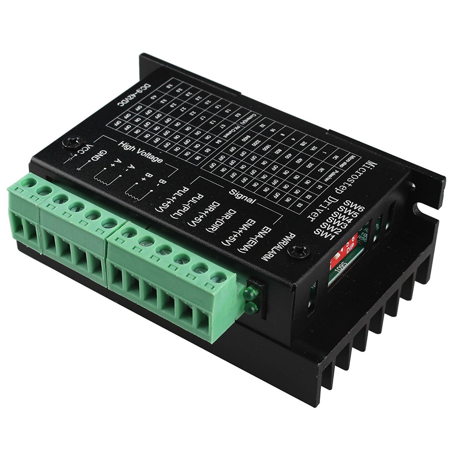

  8. Robhoski
    Robhoski New
    May 11, 2024
    18
  9. Misterg
    Misterg Journeyman
    Aug 27, 2022
    308
    239
    They look like the ones sold as TB6600, but aren't the TB6600 chip inside (not necessarily a bad thing). The TB6600 chip is very old and a bit of a dinosaur, and only goes up to 16x microstepping.
    https://www.grbl.org/single-post/tb6600-fake-or-not-but-who-cares
    You're probably picking up some resonance from the table, too. Once the air is on the plasma torch, you'll never notice :D
  10. Robhoski
    Robhoski New
    May 11, 2024
    18
    I believe you are correct about the resonance. Thanks for your input.
