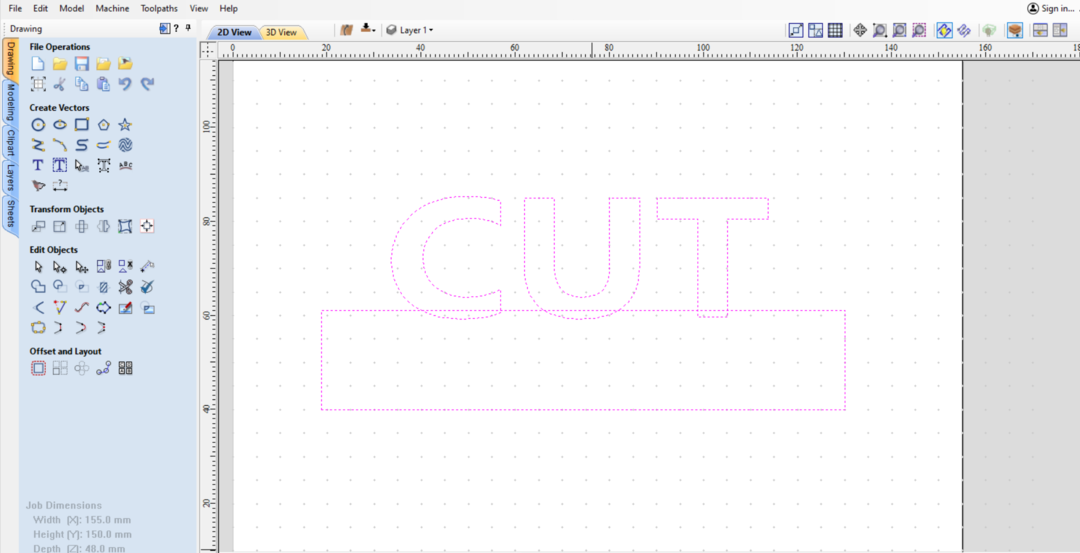

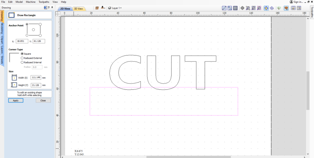

    After creating text, draw a rectangle at the bottom of the text so that the text can stand up. Use scissors tool to cut out unnecessary lines and arcs or use combine tool to combine text and rectangle into one object.

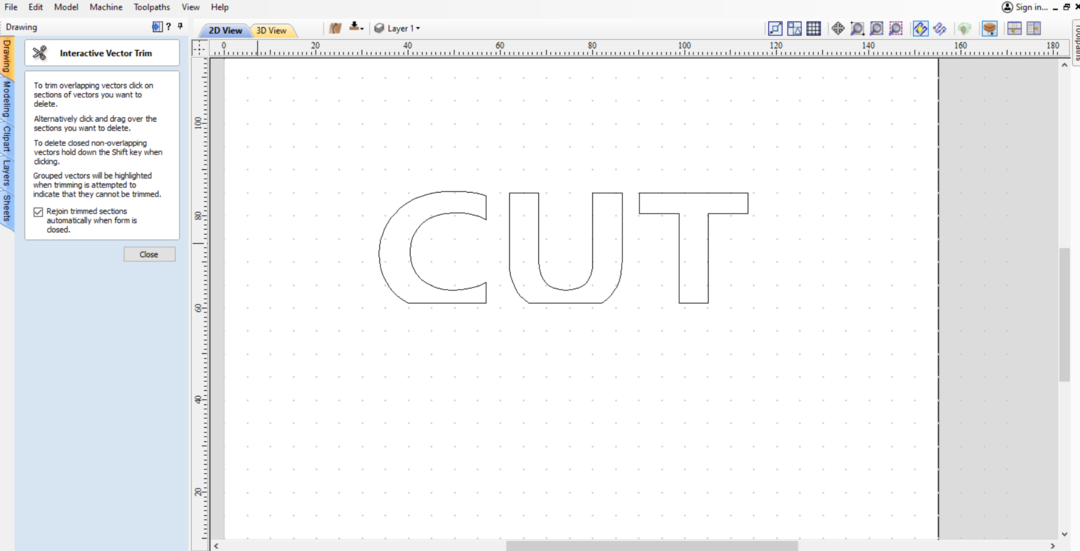

    here is a pic

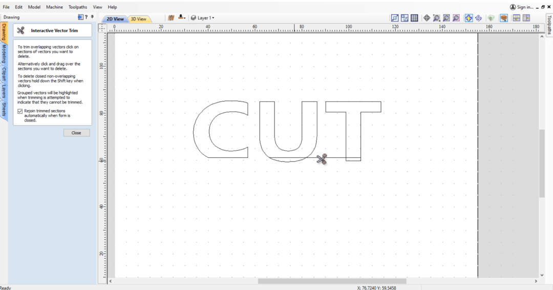

    Draw a box

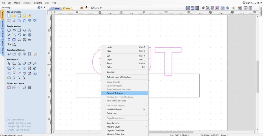

    Convert text to curves:
    Select both. They will now both be dashed lines. Before, the text was solid.
    Now you can trim with the scissors trim tool. My cuts were exaggerated.
