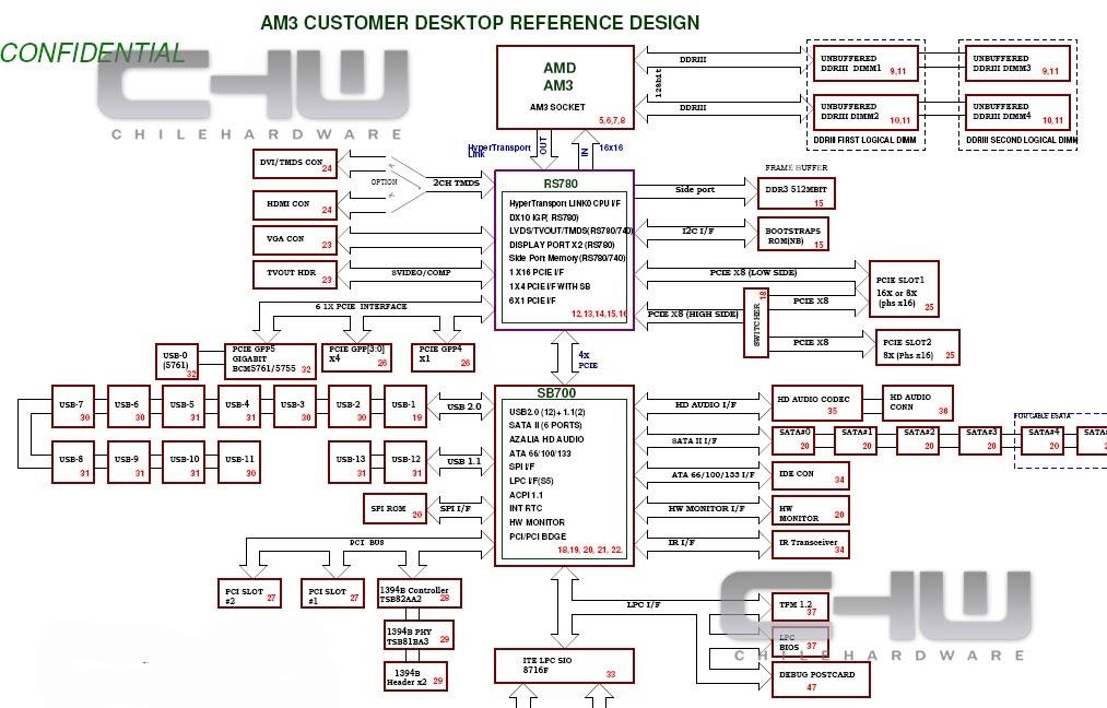

    I don't remember quite how motherboard buses are laid out (or how AMD laid them out in the socket-AM3 days) and I'm too [bat] lazy to look it u...
    Nope. As it turns out, I'm too lazy to get up and get the machine put back together again and it's easier to sit here and do a deep dive into hardware architecture.
    According to this:
    ...the parallel port & other Super IO devices are traditionally on the LPT LPC bus, off the southbridge. AMD's top sekrit AM3 reference design (made extra low-res for sekurity purposes) also puts the LPC & SIO down south of the southbridge:
    So basically 99% of the system connects somewhere upstream of the parallel port, so theoretically just about anything could cause hiccups if it managed to reserve, occupy, or otherwise DOS the NB/SB/CPU... but all three are designed to handle huge amounts of simultaneous traffic, so it'd take something big to swamp any of them (presumably the sort of "big" that would show up as exactly the sort of big spike in CPU load that I haven't seen any of).
    The more likely sounding alternative is it's something else on the LPC bus. That leaves us with TPM (Trusted Platform Module - never actually used a motherboard with one plugged in), BIOS, and the "Debug Postcard" (which I'm going to assume handles Power On Self Tests, rather than mailing back pre-Instagram "wish you were here" photos to make friends and family jealous) - none of which seem very likely - or else another Super I/O device.
    The Nuvoton/Winbond Super I/O chip is the same thing that handles most of the motherboard sensors (temp, voltage, fan speed), which explains why HWInfo is so clunktastic (Speedfan and Open Hardware monitor aren't, but HWInfo reads a wide range of sensors they can't)... but that that doesn't explain SSDP/UPnP causing trouble there.
    But then, Wikipedia also sez that Super I/O handles...(wait for it)... Legacy Plug and Play. So maybe there is more of a connection than just the name. That's where my research hit a wall, though. The best I can find is a dictionary site (of all places) saying "UPnP Is Not PnP" - nothing about whether the one piggybacks on the other, or any association between UPnP or SSDP and Super I/O or Winbond /Nuvoton chips.
    It's probably a moot point anyhow, since I also couldn't find anything suggesting a case where that machine would need UPnP. SSDP (which, while we've (I've) gotten sidetracked on UPnP, is actually the root cause) is even clearer cut. It's an IP-based network discovery protocol, and - having no need of discovering anything on the network but the SMB shares on my desktop (which use a separate protocol stack) - it's pretty clearly superfluous, aside from UPnP treating it as a dependency.
