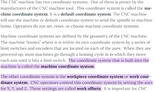

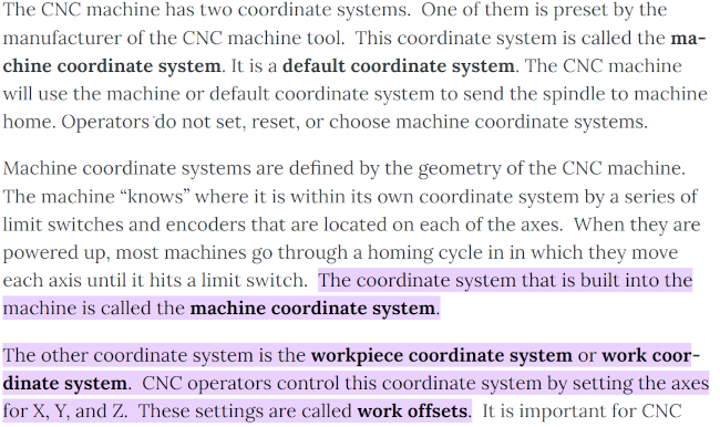

    14,026
    4,117
    Other way round. Home first, then setzero. Machine Coordinates is the base coordinate system. Every other coordinate system and stored position is an Offset from MCS.
    See above
  7. Euzikial
    Euzikial New
    Nov 3, 2021
    Set zeros in WCS or MCS?
  8. Giarc
    2,919
    1,619
    Home the machine (Machine Coordinates) . Then jog the machine to where you want to start cutting, and zero your X,Y and Z. This is where you are conducting the work (Work Coordinates) and you control this location.

  10. Euzikial
    Euzikial New
    Nov 3, 2021
    Thank you all. Figured it out
