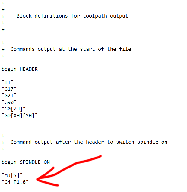

  7. Raul Rabaça
    Dec 5, 2022
    37
    Hello David
    I have a 1.5KW air cooled spindle and I control it with the Blackbox X32 and OB Interface. The spindle has a programmed ramp up speed time (in the VFD) of 3 seconds.
    I was wondering how I could set up this delay in the G-code when I saw your post. Marvelous!
    Must I put the G4 Pn command (after the M3 Sxxx) every time, or can I make it "automatic"? I'm using Aspire and OpenBuilds GRBL(mm) (*.GCODE) post-processor.
  8. Giarc
    2,916
    1,619
    Open the Post Processor and change P1.8 to the value you want and save it. In your case P3.0.
    Scroll down in the Post Processor text file until you see this. I used the OpenBuilds MM vectric post processor for the image, but the change would be the same in the inches post processor. docs:software:vectric [OpenBuilds Documentation]
