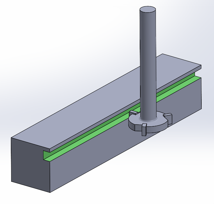

    I have a lot of repeat jobs where I cut slots in aluminum bars. Slots are typically .156" wide & .125" deep. I profile the slot with a .125" end mill in .025" passes. It works fine but it's slow. I'd like to speed it up. See below - I wonder if I could use a bit like this & cut from the side? Slot cutters exist - here's one:
    https://www.amazon.com/Yonico-14914q-8-Inch-16-Inch-Bearing/dp/B07KGJWCVW
    Does anybody have any experience or opinion of using something like this in aluminum & in a Dewalt router on a WorkBee? Safe, effective, etc?

    Could just use a router or router table, cut manually
    Gary
  3. Rob Taylor
    Rob Taylor Master
    Dec 15, 2013
    1,470
    746
    Table saw?
    Gary Caruso likes this.
  4. Gary Caruso
    May 19, 2016
    1,185
    531
    Yes, could rough it out with tablesaw and cnc to spec?

    I actually have that router bit, but I bought it to cut threads into round wooden "boxes" using Estlcam's thread cutting tool paths. I wonder if I dare go try and cut a slot in aluminum with it? Hmmmm...
  6. brrian
    brrian Well-Known
    Dec 6, 2019
    118
    51
    I did the table saw once - I don't really have the room for it, but I shoehorned it in, fixtured some stuff up, built a shroud to collect chips & went at it. It was a total mess - aluminum everywhere, and the slots ended up being inconsistent in depth so I had to mill them anyway. So yeah, a table saw could work but it's not an option right now.
