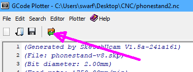

    @David the swarfer, another thing with Gplot is that when I orbit and close the program when I open it again, through SketchUCam after generating a new g-code, it opens in the last orbited position. Can this be changed that every time you start/open the program it will revert to the 'flat' position?

    no, just click the 'go flat' icon in the toolbar, either before you close it, or after you open it.
    The 'open flat' feature caused about half of the usage queries over the years <-: "how do I get an isometric view" kind of thing, esp for people without a 3 button mouse since middle button changed the angle. now middle and right buttons change angle, and the angle is stored for next time, and there have been 0 queries..... (-:
