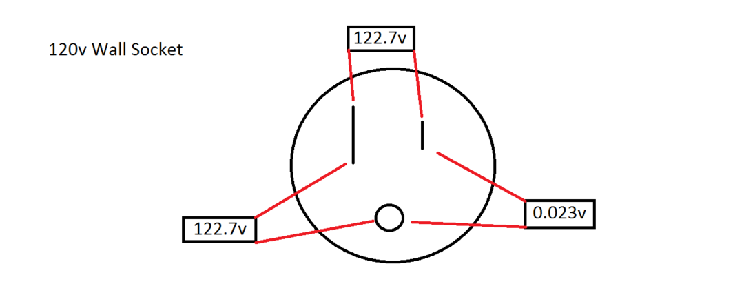

    Had a free minute and I looked over the wall outlet. Seems like the slots are reversed? 120V Outlet Voltage.png

    Yes that is reversed good find. might not have been what let the magic smoke out, but doesn't help either.

    The best solution would be to pick up a cheap outlet tester to verify the outlet. They are available anywhere home improvement supplies are sold.

    Sounds good. Ill correct the wring and order those drivers right now.
