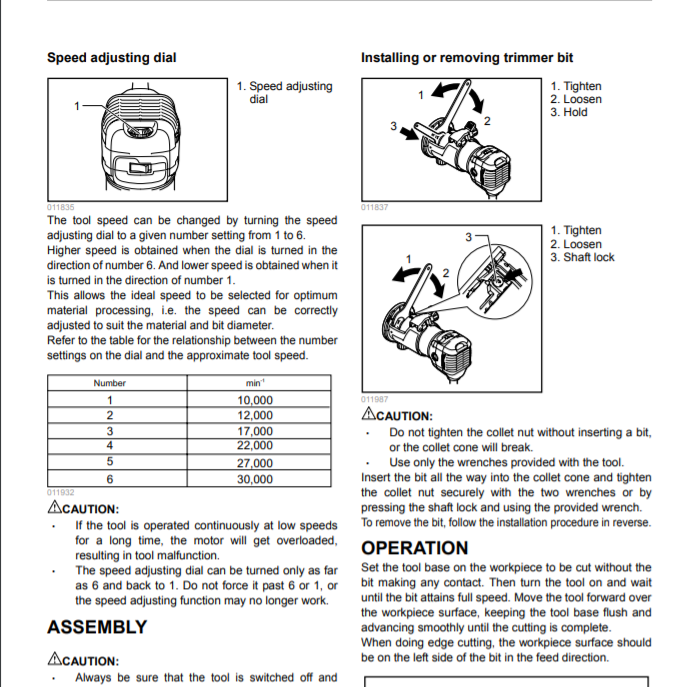

    What about Makita RT0701C router?

    Hey thank You
