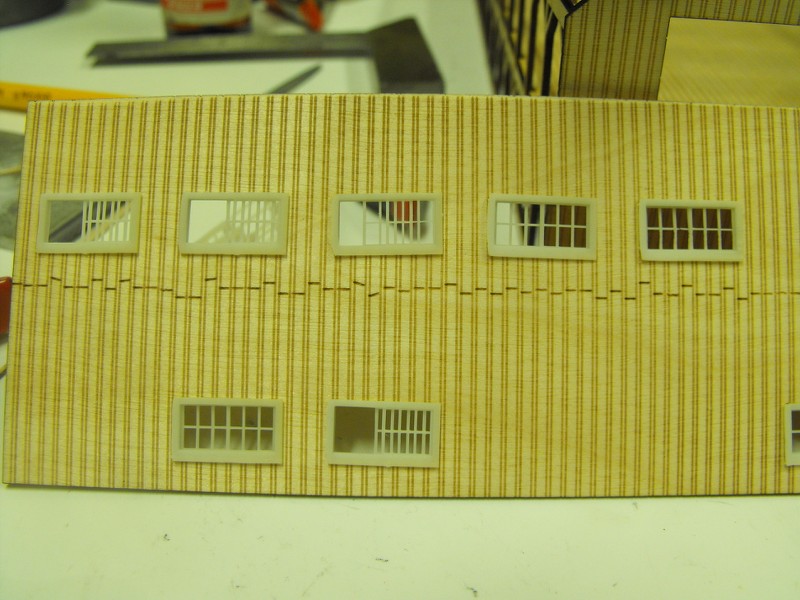

    Did a mirror alignment and it will cut the same on all 4 corners now. I'm going to cut out a N scale structure today and see how well it engraves and cuts. I'm still learning RDWorks. I need to figure out how to do all of one layer before it starts the next. I'll get the skin on today or tomorrow and make it a somewhat air tight cabinet and add a 2nd fan for extraction of the cabinet for engraving.

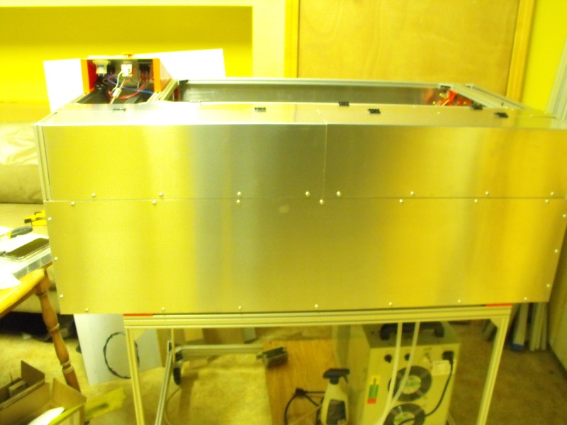

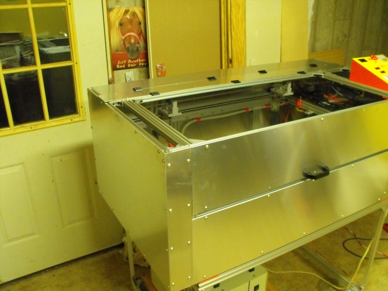

    Since cutting the acrylic, the fume extraction didn't work all that well, and I haven't tried to use it at all since. The acrylic smell hung around in the house for about 12 hours. So I started on enclosing all of it and going to have a second exaust on it.
    Ran out of the stainless screws and will have more on Tuesday.
    On the front, I have almost a 1" gap on the door for incoming air to sweep across the top of the bed.
    The plan is to have a glass window on the canopy. Need some more aluminum sheet to finish the top and figure out how I'm going to do the window
    Here is the back
    With the tube door open. You can see the water pressure switch I installed on the right side at the tube water inlet. Need to pull the tube again so I flip it on it's back to enclose the bottom

    Do you have openings in the bottom to let the air in as it sucks the fumes out?

    I'll have a duct vent on the bottom where the pipe with the fan will attach.

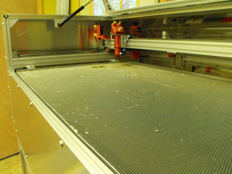

    Acrylic window in place but not sealed yet. I had this piece and it fit, so I used it instead of glass
    This is about where the bed will be when cutting. I should get great air flow across the top of it once I have the duct installed.

    The bottom is done and sealed up. I went looking for a 2"X24" HVAC floor vent for 6" vent pipe, but had no luck finding one off the shelf. Could of have one custom made, but the cost was way too much. I had this 4"X16" left over from when I built the house and it should work almost as well.
    I screwed up the 4" pipe I had on the bed, so I need to get some more to replace it. I stuck a straighten out elbow on it for now.

    Are you extracting the fumes from the bottom?
    REdington likes this.
  21. REdington
    REdington Well-Known
    98
    43
    Yes, but I'll have directional flow plates inside the cabinet
    The incoming air will be coming in the gap you see here. Airflow should flow across the bed and into exaust ducting and on to the outside.
    The secondary 4" fan will be working in conjunction with the 6" fan but the bed will be covered to keep a vacuum. Once I start using it, I throw up some pictures of it in use to help understand the complete airflow/ extraction system.
    If I get too much splashback from the honeycomb, I'll make a knife bed to set on top of the honeycomb bed.

    I'll be honest but to me it's kind of counter-intuitive. I would have thought that extracting from the top and having the air come in from the bottom would be the ideal way to go since the smoke tends to rise rather than to drop.
  23. Peter Van Der Walt
    14,038
    4,122
    That could pick up / dislodge small cut pieces, causing crashes later. Downdrafts are fantastic in a laser, "pulls" the stock down - and also, pulls the smoke out the bottom of the cut preventing sooting of the top surface.
    You also always want to Extract air (maintain negative pressure in the cabinet) - never have a fan blowing into the cabinet. It pushes fumes and smoke out every little gap. Sucking it out, much more effective.

    Negative pressure in the cabinet is the main key to keep smoke away from the mirrors and lens. They have to stay clean to keep the beam intensity at the cutting lens. If you get any smoke residue on the mirrors and or lens, it hard for the beam intensity to cut through it and thus have less power at the cutting lens. This is why lasers cutters/engravers are most generally built inside a cabinet. Secondly, it's a way to extract the fumes and smoke to the outside.

    I must have written it poorly. I totally meant to have negative pressure in the cabinet. I meant to have the passive inlet in the bottom and the active, re fan, outlet at the top. The opposite of what is done in this build.
    I can see the merit in wanting to avoid the lens and mirrors getting covered with soot. If your way works then I guess that's the way to do it. :)

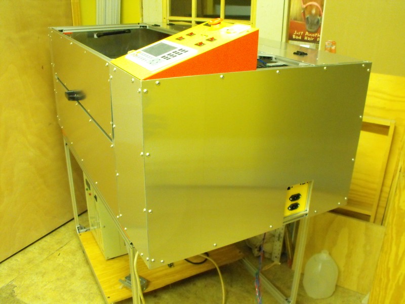

    Finally got my bulkhead fittings for the water and air lines Friday. I also put some screen wire over the exaust opening to keep debris out of the fan blades.
    Hope to finish all the venting to the outside tomorrow.
  27. REdington
    98
    43
    Have all the exaust venting done, but it has been somewhat of a nightmare trying to find all the right fittings off the shelf. Originally, I was going run both the 6" and the 4" to the outside separately. While getting some supplies, I started piecing parts together and decided to try to get both into one vent to the outside. The 6" going up is the cabinet exaust and the 4" is the bed exaust. Just before the elbow on the 6", the vent pipe increases to 8" diameter. I used aluminum tape and taped every joint and seam, so no fumes escaped through any of them.
    Two steps forward and one step back again.
    Now with all the venting done, I went back to level the machine up and couldn't do it. When I installed all the skin, I didn't have it level and when I tighten all the skin down, it made it too rigid. So I tried just loosing all the screws and it wasn't enough. I had to take the rear panel and the big panel on the front off and oblong a few holes. I got it level and tighten everything all up and did a finial mirror adjustment. I cut some 1/8" acrylic and it did a great job of cutting. The exaust extraction worked super well. All the fumes were sucked out and had no smell left in the room. The cabinet blower is strong enough that if any loose paper is in it, it gets sucked to the bottom vent. Good thing I put the screen wire over it.

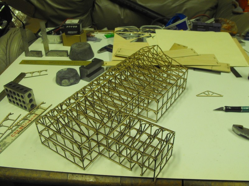

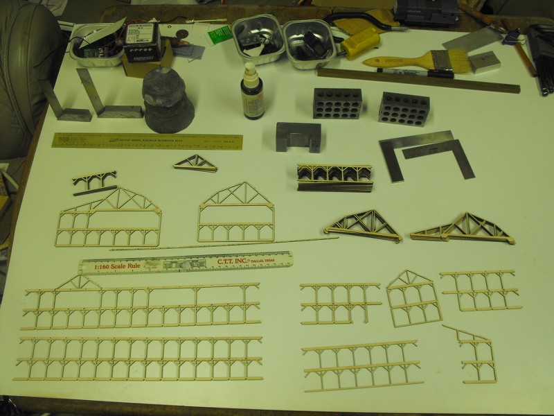

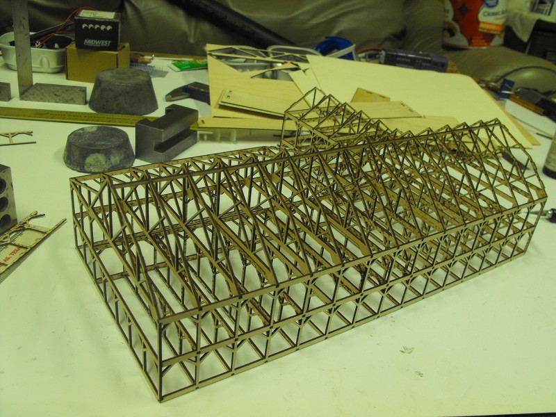

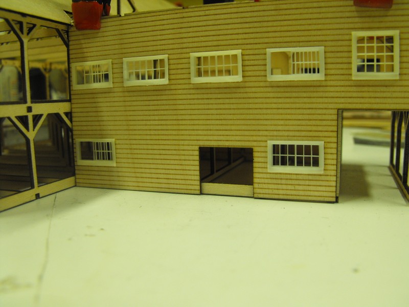

    One of the first projects was a sawmill for my model railroad.
    Here is the framework in CAD
    Parts cut
    Framework glued together
  30. Alex Chambers
    2,700
    1,327
    Nicely done! But you have hidden lots of that beautiful framing.
    I'm building a cotton mill for a model railway based in Yorkshire UK, and I have 3d printed lots of machinery for the inside, including facsimiles of the drive belts that would have been driven from an overhead shaft, but you can hardly see them through the windows :(:p:cry:
