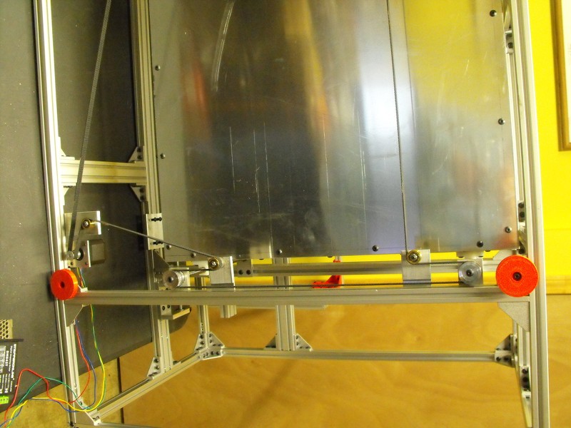

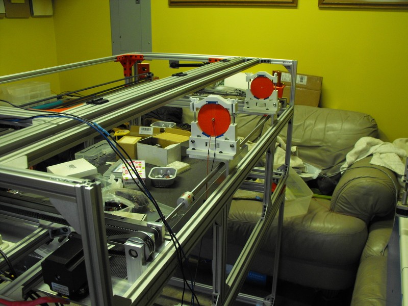

    I ordered the Cloudray Ruida RDC6445G controller and should be here by the end of the week. I will need some help from someone when I get ready to set it up to the spec's of this machine.

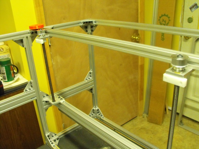

    Still waiting on pulleys for the Y axis drive and reduction box. The case as I had drawn up was only 49" long and I added 4" to it so I can use the RECI W2 tube I have, instead of the 60 watt.

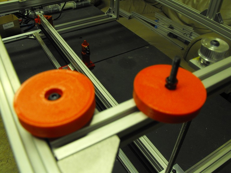

    I printed up some leveling feet and this will also give me a little clearance I needed for the Z axis pulleys. I drilled and tapped a M5 hole on 4 corner braces for them.

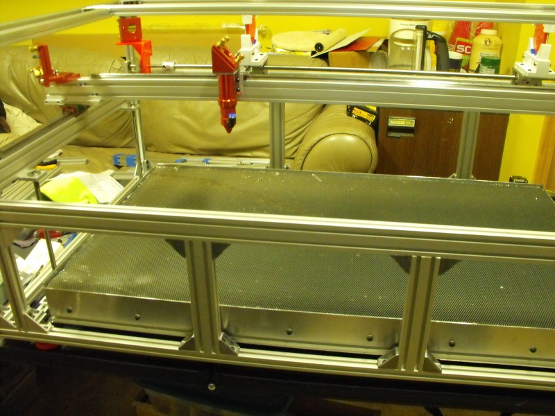

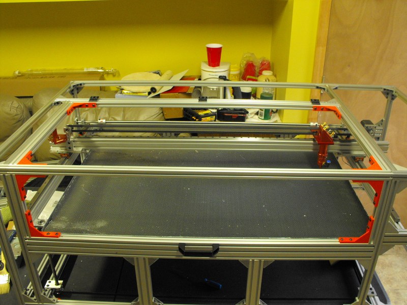

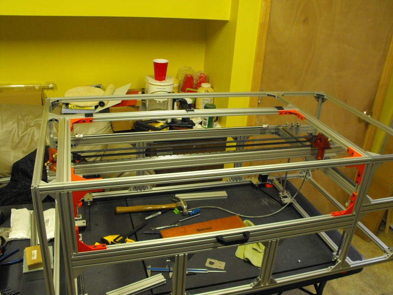

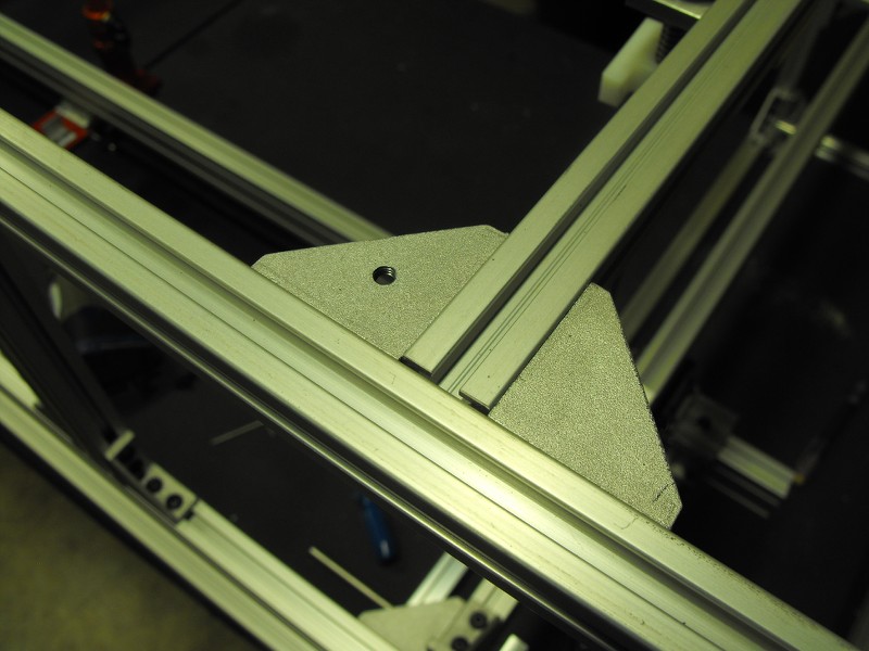

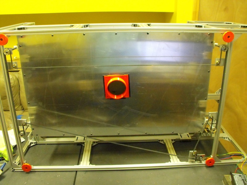

    A little more done
    Bed is ready
    And mounted
    Tube mounts are next and then start mounting the electrical stuff and wiring
  3. Kevon Ritter
    Kevon Ritter Veteran
    Apr 30, 2015
    597
    293
    One thing to pay attention to is the canopy edge gap. I wouldn't hurt to actually make the canopy frame slightly smaller than it's intended spot. You can always overlap the cover/skin/acrylic, but the canopy frame has to slide past the rest of the base frame.
    REdington likes this.

    Yea Kevon, you can't see it in the photo, but there is gap on both sides.

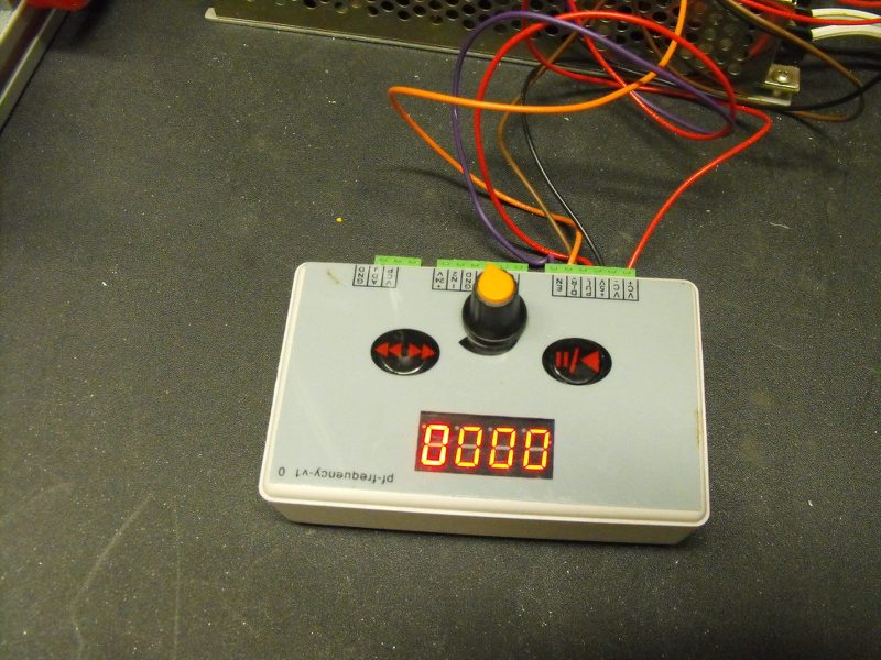

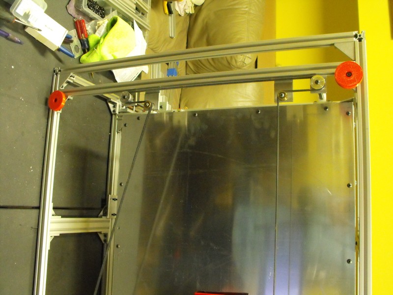

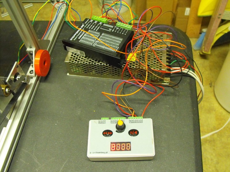

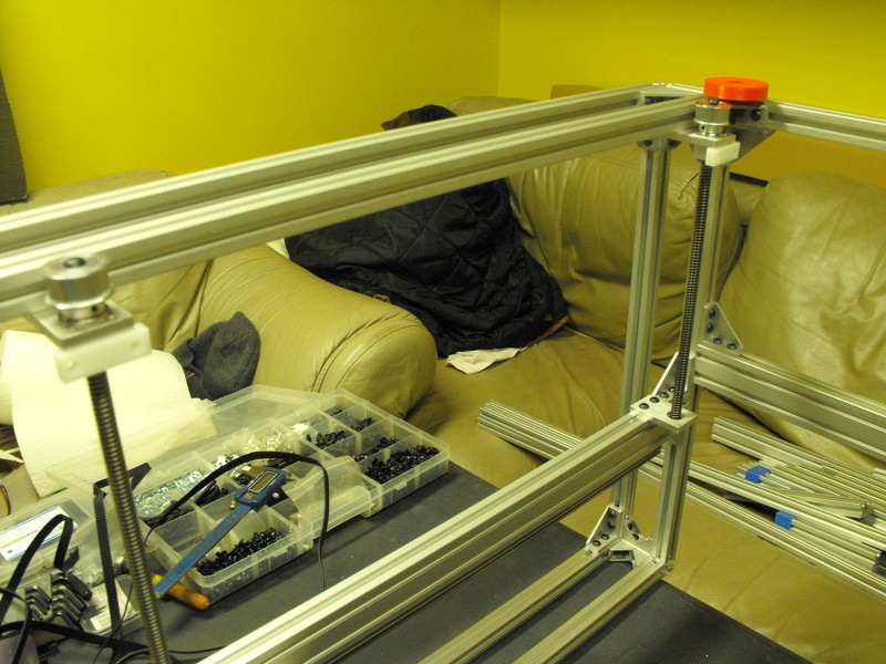

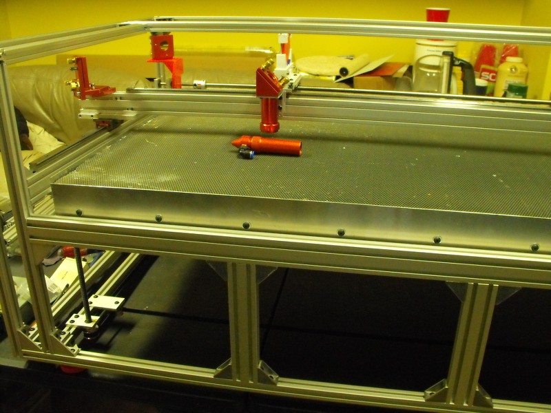

    I have gotten some more done. The Z axis is working smoothly. I need to build the stand for the laser before I finish leveling the bed to the both axis. The bed has a little over 8" of travel.
    I picked up this stepper controller a few years ago and it works great for testing.
    Bed at the full raised position
    And at the lowest position.

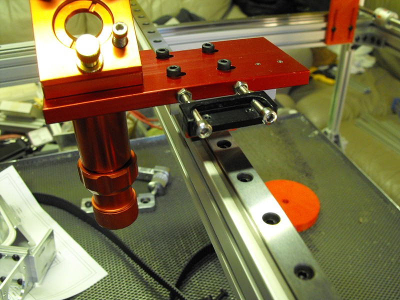

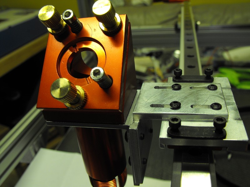

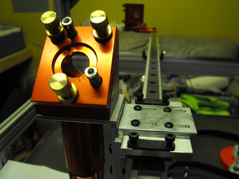

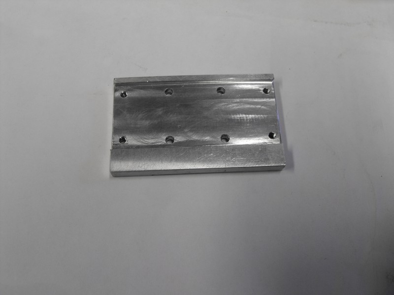

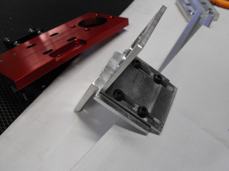

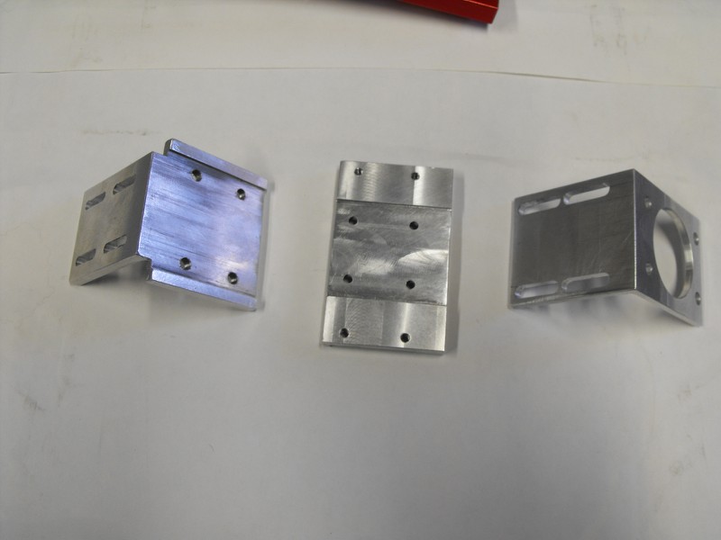

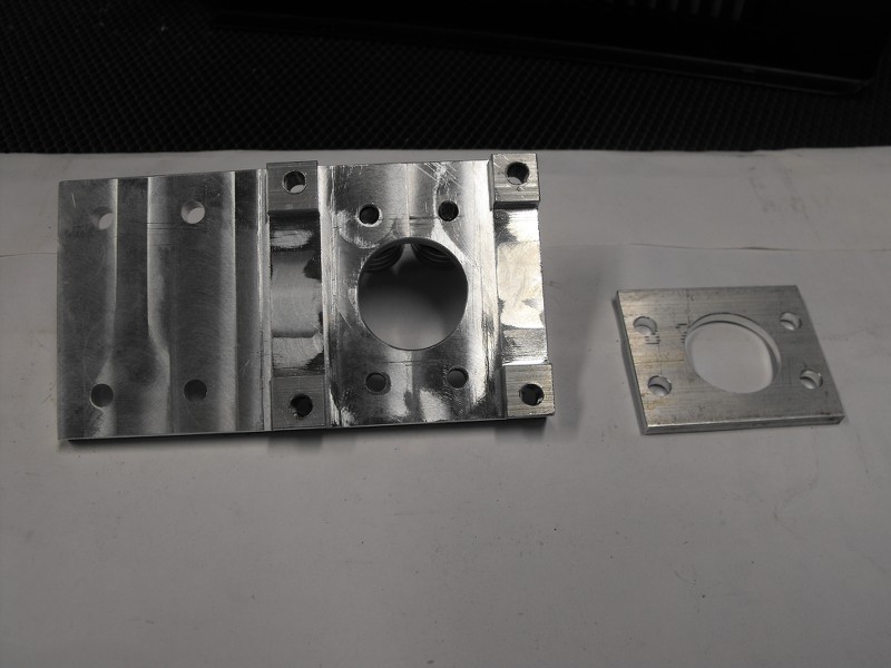

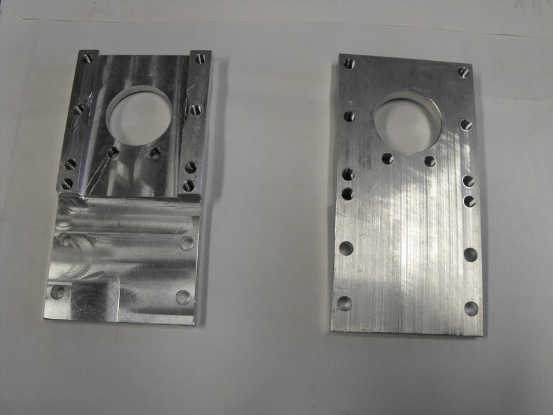

    After watching more of Russ's videos, (Sarbarmultimedia on youtube) I really like his idea of making a adjustable head mount. So I spent some time at my Bridgeport making one to fit my 12mm top mounted rail.
    The original way I had it mounted was the head mount was bolted to a converter block that I had made.
    I ended up with 3 plates. the middle plate goes on the bearing block.
    Bottom of the bearing block plate. I milled it so the bearing block has a tight slip fit.
    The other two plates bolted together
    And mounted to the rail
    At the highest level and closest to the rail
    Lowest level and farthest away from the rail.

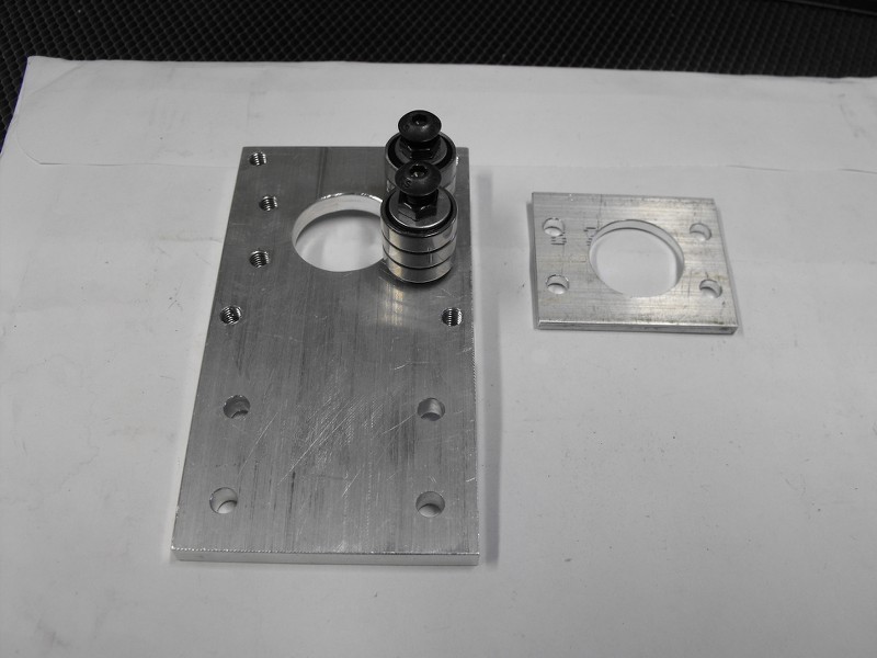

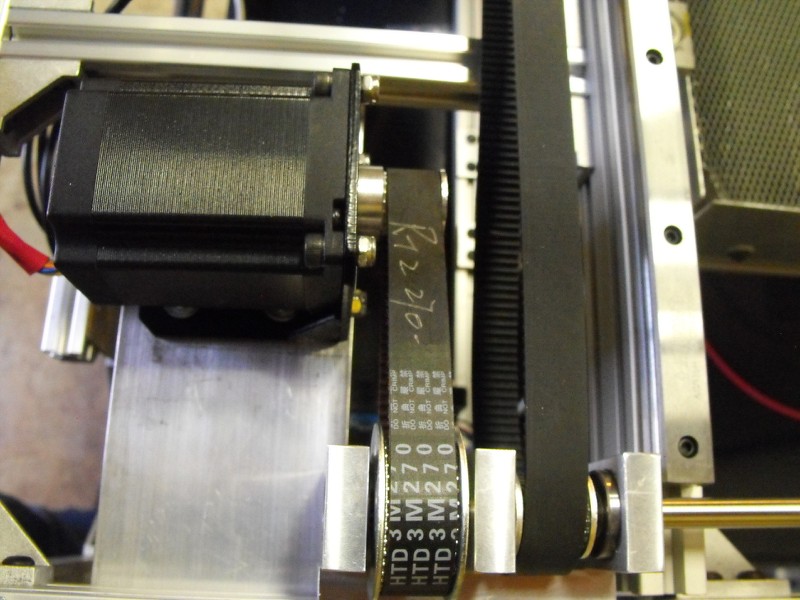

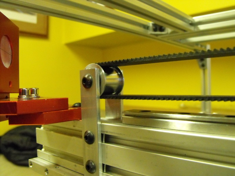

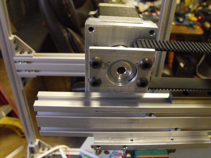

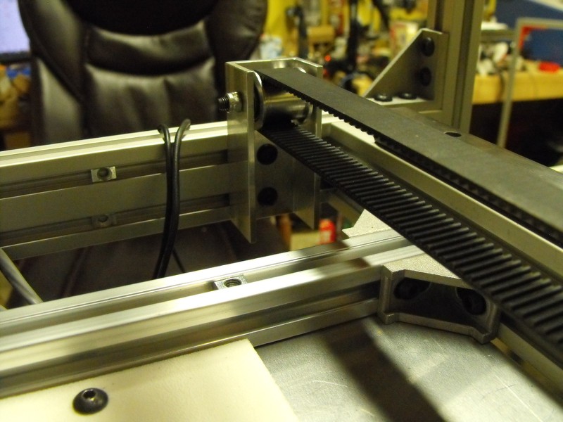

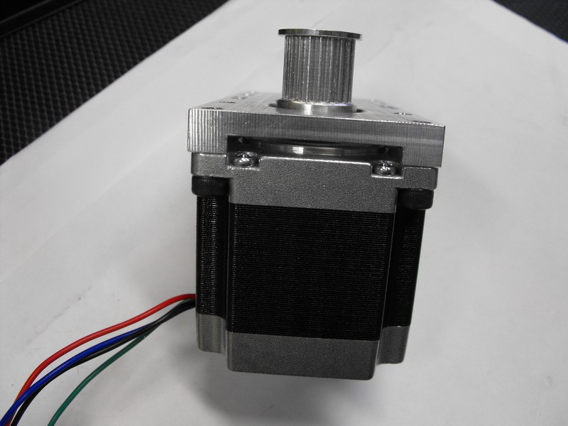

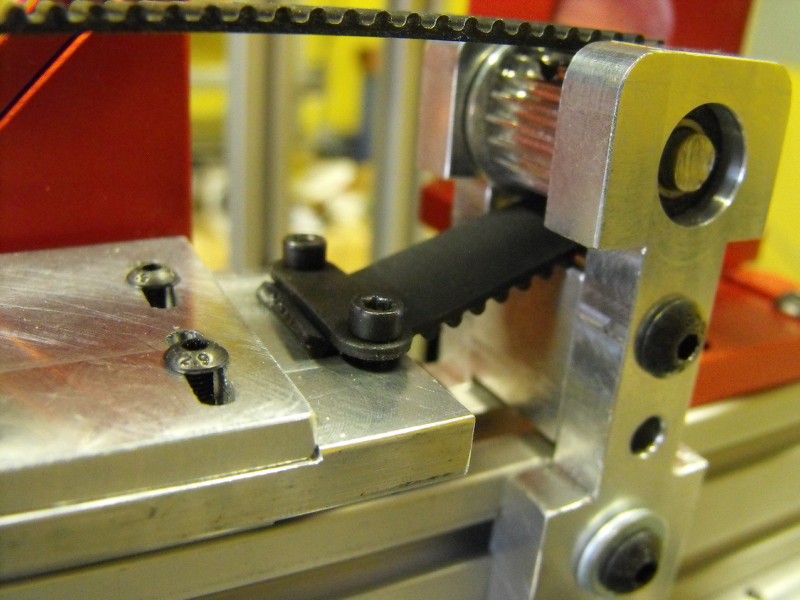

    Been working on the X axis rack drive.
    This is what I came up with. I made a extra just in case I ever build another laser.
    Plates
    With the motor mounted. I need the extra offset cause of the pulley.
    Mounted in place on the axis

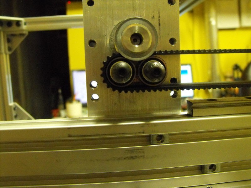

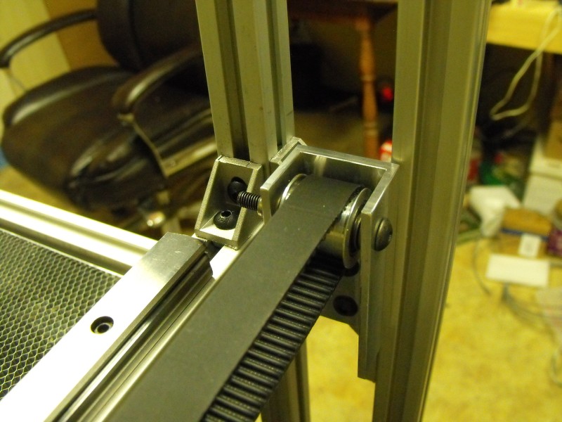

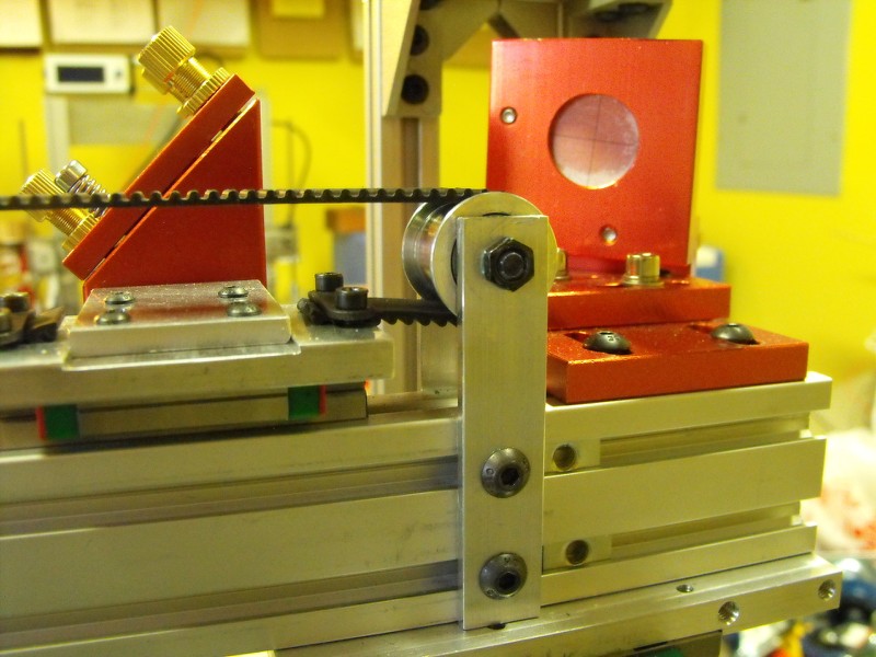

    Well, crap, that won't work. Back to the drawing board (CAD). I could try it this way, but I think the slight rub will generate some heat and wear the belt.
  14. Peter Van Der Walt
    13,749
    4,070
    Not enough teeth engaging. Try to wrap around the pulley, the more teeth engaging, the better.

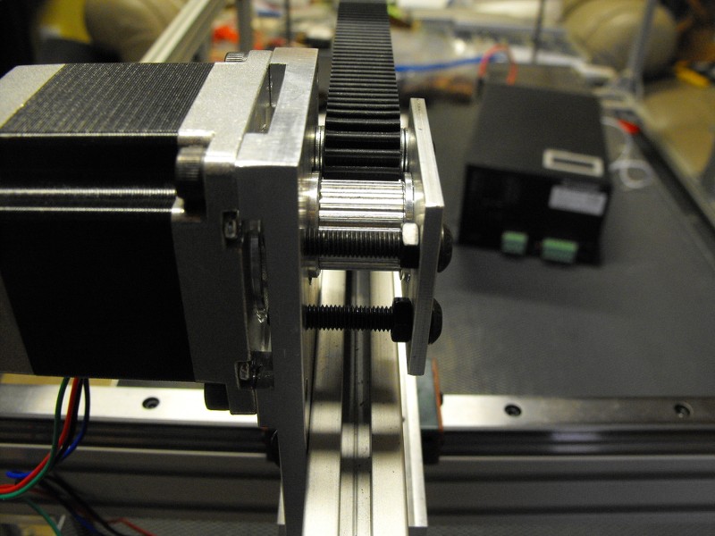

    So in CAD, I just basically turned the plate 90 degrees and made another set and lightened them as much as I could.
    Mounted in place
    But now I need to make another idler pulley bracket. The new one will be more of a traditional one with the bearings in the idler itself.

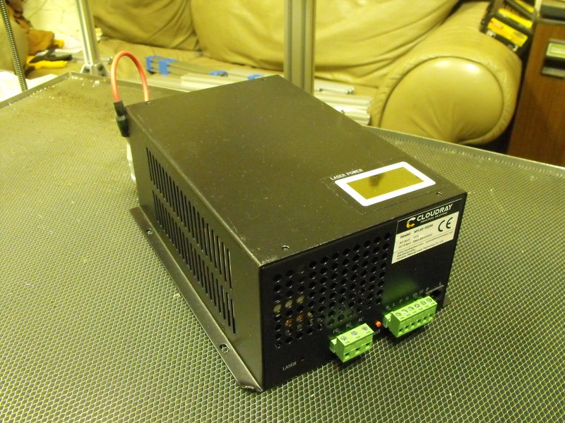

    Got the 100 watt laser power supply a couple days ago

    First, thanks for the comment, but wrapping the belt around the pulley is what I'm trying to avoid.
    If you ever watch Russ's videos, the rack drive does away with the uneven engraving that the belt leaves as it goes over the pulley. As far as teeth engagement, I have enough for it is only driving the laser head. If you go to this video and start watching about 8 minutes in, he explains what this rack drives does.

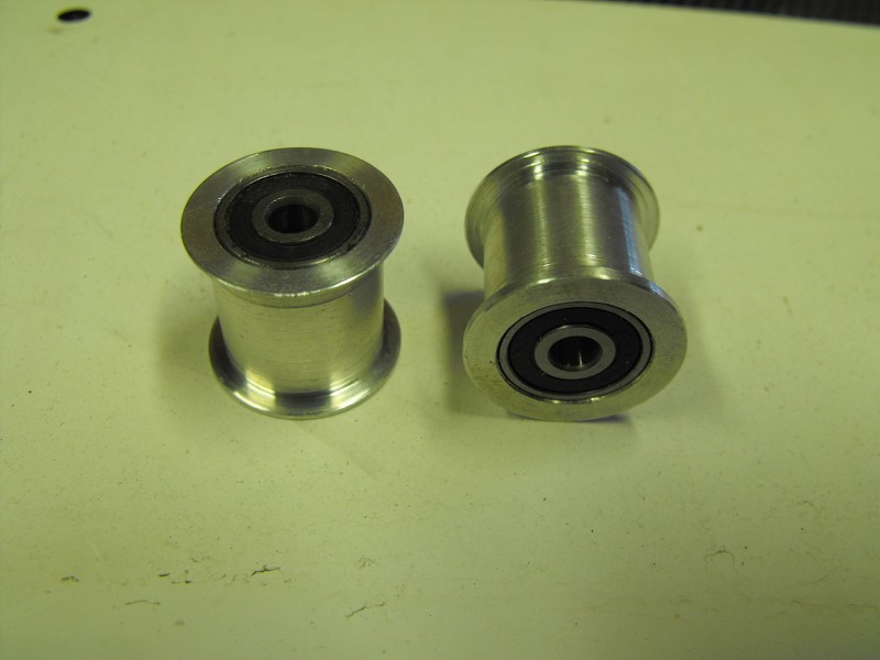

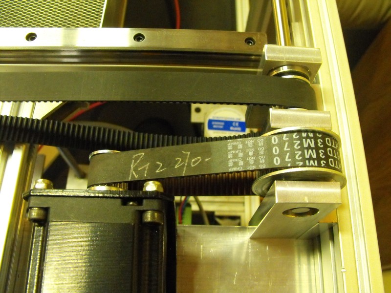

    I turned 3 smooth idler pulleys, one for the X axis and the other two for the Y. The X axis has great alignment now. I'm in the process of making the brackets for the Y idlers.
    One step forward and two steps back.
    Using my 10" machinist square, I squared my "Y" rails to the common beam on the back that will also hold the tube. When I did this, it threw the bed all out of wack and now have to go back and readjust the Z axis leadscrews. In the process, I think the NEMA 17 I had on it was missing steps, so I put a 175oz NEMA 23 like I have on the X axis. Mounted the driver and have the motor wired to it.

    Y brackets are done and belts is tight.
    Y motor and drive

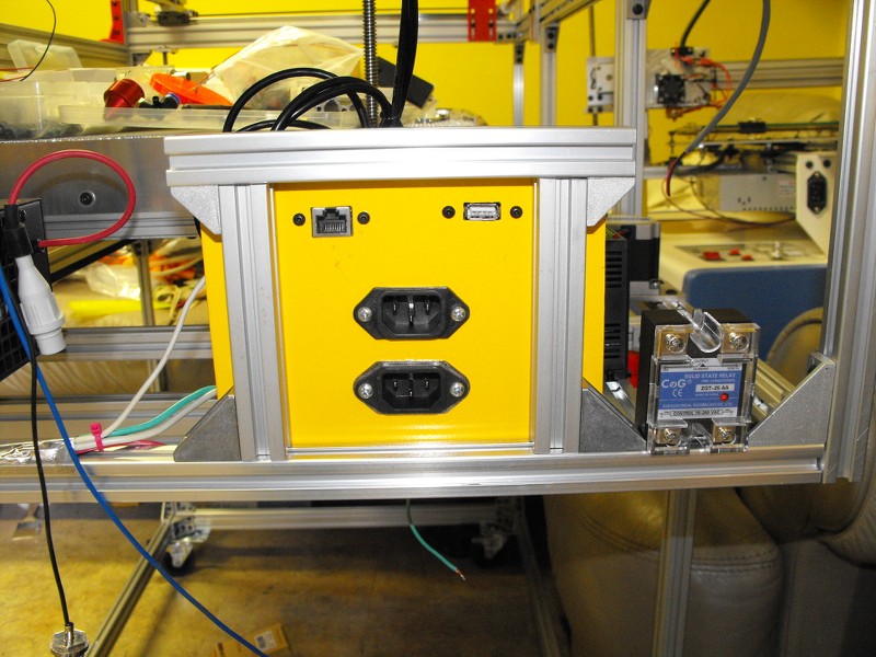

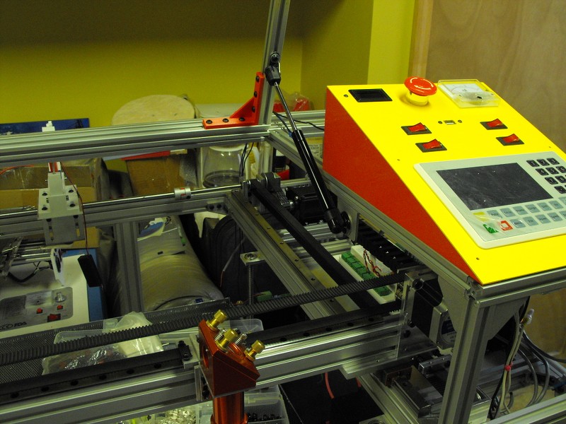

    All the 110 volt wiring is done except for a SSR that will turn the CW 5000 chiller on when the laser tube power supply is on.
    All steppers are wired as is the power to the stepper drivers. Need to do the limit switches and control card to stepper drivers.

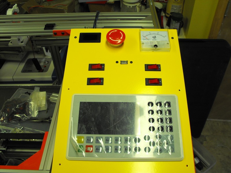

    Control panel is made of .062 aluminum
    Upper left is the water temp then emergency stop and amp gauge
    The lower left switch is main power. Above it is the laser power and chiller
    The lower right is the exaust blower power supply and the other is extra.
    And the U-Disk is in the middle.
    Incoming panel
    Bottom is main laser power. Top is chiller. The others are computer connections.
    Canopy struts are on and adjusted. Kind of stiff till I get the skin and glass installed.

    Compressors are hectic inductive loads (startup, gas under compression) so a SSR may not be ideal. They don't like inductive loads.

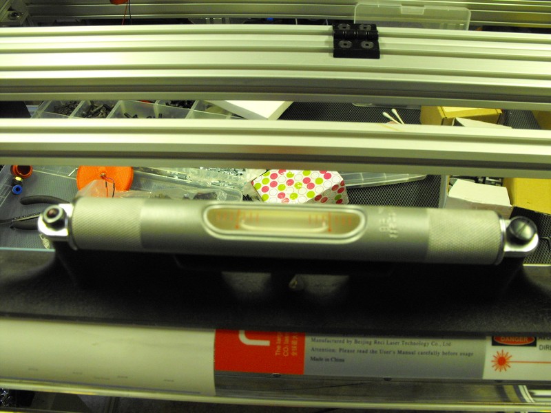

    Took my Starret level and leveled both Y axis rails and the X axis rail both for and aft.
    With everything all level, I leveled the tube and then took it out and added some disks I printed to do the preliminary mirror alignment using a laser pointer that I made.

    Wow Peter, Didn't know that. Thanks for saving me on this. I will use the extra switch for the chiller then.

    I really want to keep the laser power supply and chiller together to keep the chance of tube failure caused by no water at a minimum. So after some thinking, I'm going to put the chiller on the switch and the power supply on the SSR.
