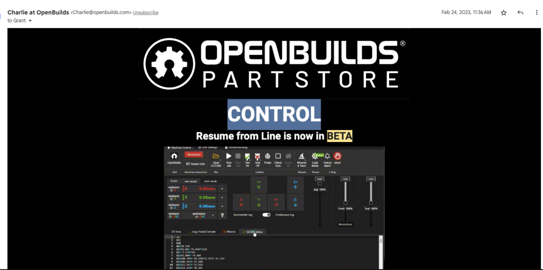

  8. GKTRK
    GKTRK New
    Jun 13, 2022
    87
  9. Peter Van Der Walt
    14,701
    4,249
    Yeah, couple months now. That email was the announcement after all :)
    Under Wizards and tools, or as right click in Gcode editor. Still beta of course
